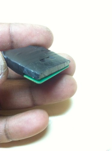

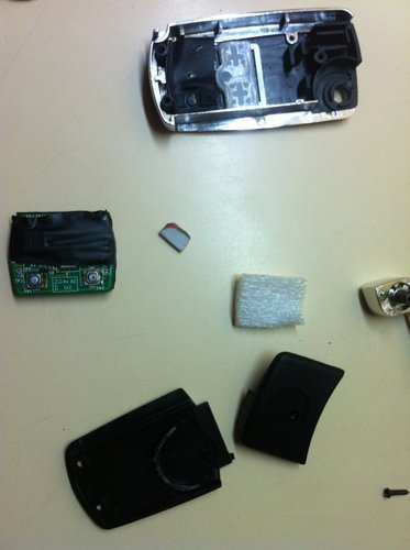

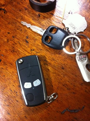

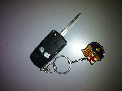

Nah n4l, Mitsubishi wasnt that advanced in our keys just yet.
Ice has the same key setup I had, Its one with a lock/unlock function and a regular spare key.
Theres no immobilizer chip, just the electronic board to transfer over to the new shell.
The problem is, the board does not line up exactly with the replacement shell.
So I had to cut out a new hole for the unlock button.
Its some stress but worth it if you want the look coz you literally have to butcher the old key shell.

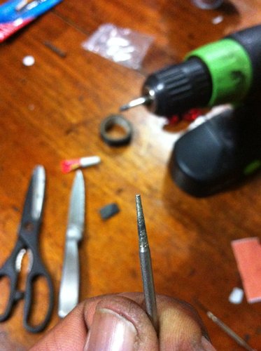

Postby idlemind » February 7th, 2014, 11:27 am
Reverse the order of them pics..
Yes thats electrical tape holding the battery between the circuit board and hard shell.
Notice the hole I had to dremel out to fit the board vertical instead of horizontal.
So the black button was now unlock. The unlock button was useless.
