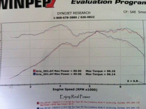

Postby wagonrunner » December 3rd, 2013, 1:22 pm
can you post your dyno chart?
1.5 cvt made 90whp by audi at dyno day this year.
betting that 2.25" exhaust robbed of you of some torque.

Re: The Official CS Lancer Thread!
Postby idlemind » December 3rd, 2013, 2:43 pm
wagonrunner wrote:can you post your dyno chart?
Nah I know what did.
I have on two resonators.
The GDI exhaust is bigger than the 4G18s and I have a 4G18 with GDI exhaust.
I had to cut down the noise and by extension the air flow by adding another resonator as wifey was complaining too much. Noticed the performance cut immediately after.
Think il take it out seeing that its for sale.
Postby wagonrunner » December 3rd, 2013, 9:26 pm
the torque is better though. 4000-4500 musbe feels like waiting for vtec
