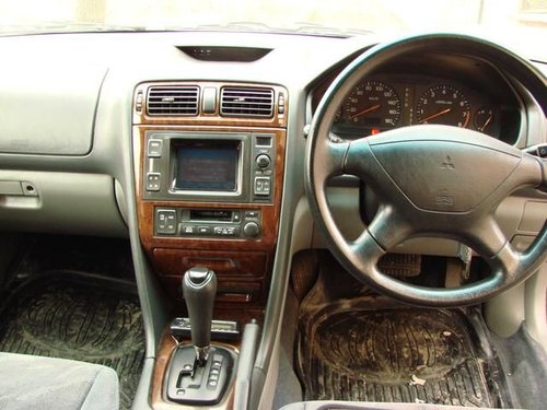

Anybody knows how to remove that wood grain finisher and how to get to the deck? Want to change the deck.
de_dougla_smurf
Posts: 791
Location: Dong South
Re: The OFFICIAL Sharkmouth Galant Thread
Postby de_dougla_smurf » September 4th, 2014, 11:50 pm
You need to remove the trimming around the gear lever first with flat bladed screw driver. there are also two screws pointed upward in the ash tray, get them out before you attempt to pry out the console. Its held in place with clips, so with a little patience you should be able to get it out. Pull it evenly to the back of the car.

Thanks. Forgot to post a pic of the finisher I was referring to for clarification. Here it is
