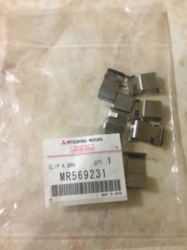

Fellas hearing a lil shimmer from front right evrytime i go over a hump or hole n the road
Check brake pad shims and the anti rattle clip, also checked the pin dat goes into the outer end
thinking it make be the spacer from the stabillizer bar end hitting the cradle arm?
Any one experience this b4?Any ideas?

nissan4life wrote:lol.xtech all yuh good yes.
Cradle bushing??
The spacers (washers) on the stabilizer bar linkage are usually torqued tight enough to prevent any rattle. You can also check the big stabilizer bar bushing that's mounted to the subframe. From my experience they may look good but only when you take them out do you see how worn they really are.
If you never changed it, now is a good time.

BrotherHood
Posts: 8250
Re: The Official CS Lancer Thread!
Postby BrotherHood » July 18th, 2013, 3:02 pm
:lol: @ wukkin PH. FYI, I don't. I have done an extreme amount of driving past couple months so I am not suprised if my transmission oil needs changing at the moment.
Biggs, I haven't put the brake pad clips in as yet. When I do(this weekend), I will let you and the group here know if the vibration has ceased.

idlemind
Posts: 3329
Location: (-(     )+)
Postby idlemind » July 19th, 2013, 6:06 pm
ZeroOne wrote:
idlemind wrote:Have a wedding to attend. Really wanted to run this one.
Anyone has extra brake pad clips?
I changed my brakes recently and realize a couple are missing. Could've fallen out when the pads got low. Bought the new set of pads without clips and DM doesn't have the clip set in stock. Push come to shove I might look for new pads that come with clips.
DM rob yuh OEM brake pads does come with the clips.
FYI Zero, Clips don't come with the brake pads. It's a separate kit.
ZeroOne
Posts: 2253
Postby ZeroOne » July 19th, 2013, 7:50 pm
yea just remembered that. I didn't get any for the front either.
mixed it up with the clip on the rear brake pads
