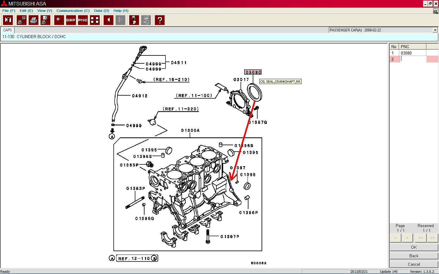

ZeroOne wrote:heres the diagram of the torque converter.
Transmission oil is leaking out of the bottom so im trying to figure out which seals to change.
So far Im only seeing 1 seal 27097
Zeroone i think brotherhood had this problem earlier this year,cant remember exactly what seal he changed but if my memory serves me correct its back crank seal and torque convertor seals.He may be able to assist

ZeroOne if it's not that seal then it's most probably 26136
is the transmission oil leaking from between the engine and tranny?

yes leaking from between the engine and tranny

^^^ make sure you change the crankshaft seal as well

will do.
Looking to change all necessary seals while im at it
found the post viewtopic.php?f=33&t=98180&hilit=seal&start=10170#p6823596
Im reading that the leak was from a side panel and that the tranny does not have to come down to change the troque conv seal.

yeh once oil leaking out the converter housing then 26136 is the culprit..I suggest you change both axle seals one shot

ok, so tranny does not have to come down right?
ronsin1
Posts: 3671
Re: The Official CS Lancer Thread!
Postby ronsin1 » March 20th, 2013, 12:44 pm
^^^ no it does not
Yep, that's correct. Transmission does not have to comer down. Jai's Transmission in Aranguez did the labour for me. Cost me $300 to fix. Dropped the car before I went to work around 9ish qand they called me around 3pm and said they were done.

BrotherHood what seals you changed?
ronsin1 The back crankshaft seal is where exactly?

ZeroOne wrote:BrotherHood what seals you changed?
The leak was on the back cover of the transmission. Those were their exact words, the guys that did the labour that is.
Also changed axle seal.

Postby turbo_beast369 » March 21st, 2013, 12:28 pm
You have to unbolt the flexplate from the crankshaft to get to that seal

Thats close to the timing belt?
cause I changed a crankshaft seal when i replaced the timing belt.

Postby turbo_beast369 » March 21st, 2013, 1:04 pm
Timing belt is on the other side of the engine...you changed the front crankshaft seal

the back is the end of the engine that is mated to the transmission

just spoke to my mech he said I should change 3 seals:
1. Transmission front shaft seal
2. Torque converter housing seal
3. Rear engine crankshaft seal

on ASA there isn't an option to buy the torque converter housing seal tho

Just called DM, Transmission front shaft seal and Torque converter housing seal are the same thing.
Yes it is sold for 130+VAT
Rear engine crankshaft seal selling for 270+VAT
