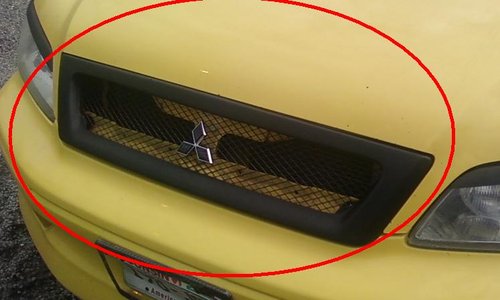

Good Day guys looking for a grille like this for my 2003 cs lancer any help would be grateful
