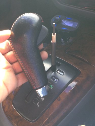

Postby SUPERMAN NY » June 22nd, 2016, 11:01 pm
Hi guys! can u pls assist me in locating/repairing this issue thanks! the white piece was broken up when i unscrewed it. Can i get that part or will i have to buy the whole thing?
BrotherHood
Posts: 8250
Re: The Official CS Lancer Thread!
Postby BrotherHood » June 23rd, 2016, 11:15 am
SUPERMAN NY wrote:Hi guys! can u pls assist me in locating/repairing this issue thanks! the white piece was broken up when i unscrewed it. Can i get that part or will i have to buy the whole thing?
Check Diamond Motors. Got my mine there about about two years ago for around $100. That's for the plastic cap itself.

Postby nissan4life » June 23rd, 2016, 1:36 pm
Wasnt there a fix for this already?
check the link
http://trinituner.com/v4/forums/viewtop ... start=9990
