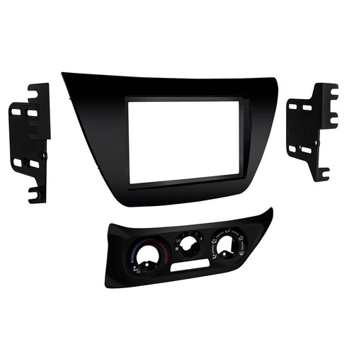

Convert ur cs3 to double din with this dash kit. No blocking of ur ac vents. Moves the ac control down to the lower pocket $600. Colour black. Pm for info.

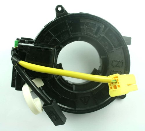

Spiral for Cs lancer 2002-2006. NEW. $700 pm for info
