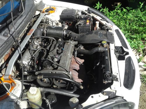

Running premium, significant reduction in knock but still there ,working on retading timing.the engine loves premium it is almost as if it is saying "yum yum"(better performance) changed to 210 cc(cdh 210) eliminated lean burn situation.looking for greddy emanage blue, cheapest i can get right now before I switch to AEM EMS-4.

I was planning this for years so I am not naive(no offence taken) I am a Tobagonian I live in Castara
12 miles from the capital(country)lot of hills and corners so my project is about high speed cornering and ample torque(150 ft lb).With that in mind 6a12 v6 will make my car too front heavy(car points into corners better with less weight in front eg.cs6a gdi turbo on the same coarse tend to under steer handled well but under-steer was prevalent and also when i did gearbox conversion car was more responsive to steering input. Next 4g18t(think you mean 4g93T) is the best idea but would not work back with the ABS(ECU and ABS ECU),4g93 sohc only produces 118hp with 117 ftlb of torque I can easily get that from my current build and the availability of DOHC conversion is slim,can make a better turbo project cause of bigger displacement (1800 cc) but weight conscious, although i saw a 4g93 dohc in a cs9a in russia (FIRST TIME I EVER SAW ONE with cams on right hand side ) and 4g92 mivec nice but ABS communication probs just like 4g93t(ck model engines).Not willing to give up ABS cause my car came without it and I had to painstakingly install it myself :x so in essence was trying to stick to the cs side of things so to speak , if I had a ck no probs but I choose cs because of more rigid chassis which I perceived as better for handling.My aim is to go turbo to get the torque.You might say little gain but almera(qg 1.6) tiida 1.5 and 1.6 autos was putting bad licks on my 4g15 sohc gearbox now i run passing them no longer have any respect for them my pros are
1. more torque from 4g18 stroke 87.3mm vs 4g15 82mm(main reason for build)
2.More responsive like a 4g92 mivec(same sharp response and sharp exhaust sound)
3.still have room to work in my engine bay( thank god so repair work is not so hard)
4.MPG is still acceptable even with premium
5.learned a whole lot about engine modifications and gained the respect of a lot of top level mechanics on the island.
6.last and not least loving the third gear pulls on highway sound sweeter the more it revs (which it likes to do) the power is kinda high up in rev range 3500 on wards to 7500 rpm, coming from a 4g15 92hp sohc engine this is a lot, every time I drive I have to smile it is sooooooo sweet, now is not just point A to B it is miles of driving pleasure

the pics
