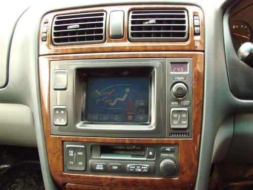

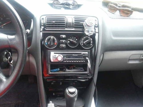

Guys can anyone tell me if the digital ac control in the Galant can be changed from the double din type (first pic) to single din type (second pic) please? Can the same wiring harness be reused, ie. just jack out from from the big control and jack into small control?

Posts: 3004
Re: The OFFICIAL Sharkmouth Galant Thread
Postby xtech » September 6th, 2015, 8:56 pm
Yes straight swap. Wanna trade?

Please help looking for this center dash and ac control pleaseee! Any help will be appreciated!

the yellow car wrote:Please help looking for this center dash and ac control pleaseee! Any help will be appreciated!
Only the local galants came with those i believe, would be hard to get.
What is wrong with yours? If it's the temp control or fan control knob that isn't functioning you can source a ck lancer controls and swap the controls.
NR8 wrote:Guys can anyone tell me if the digital ac control in the Galant can be changed from the double din type (first pic) to single din type (second pic) please? Can the same wiring harness be reused, ie. just jack out from from the big control and jack into small control?
Interested in this myself, heat damaged my screen and left some unsightly lines. Want to swap with the single din ac controls and install a double din dvd deck.

Postby the yellow car » September 18th, 2015, 7:54 pm
My galant got broken into a while ago and they destroyed the center dash, so the only one I could get is the center dash that comes with the digital ac control, so the whole thing just looks awful... I wish I could install the digital ac control but I doubt that's possible unless u know of a way?

Postby rollingstock » September 18th, 2015, 8:11 pm
^ Nah that's as you said almost impossible.
Too much would have to be done to get that working.
Only bet now is to look for a crashed local galant.
