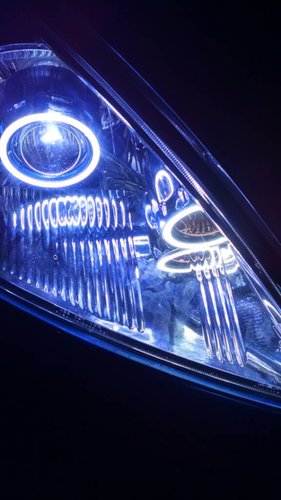

Morpheus wrote:Nice. Awaits pics...
x2....
Re: The Official CS Lancer Thread!
Postby cinco » March 30th, 2015, 10:04 pm
Teaser
BrotherHood
Posts: 8250
Postby BrotherHood » March 31st, 2015, 11:09 am
:D :D
Looks blue.... but is really isn't that colour. Had to adjust the camera settings to get a clear pic and hence the blue hue.
ZeroOne
Posts: 2253
Postby ZeroOne » March 31st, 2015, 1:10 pm
There is an aftermarket DEPO lamp like that though.
The CS2 headlights with halo is probably cheaper to retro fit than to buy.
Postby cinco » April 1st, 2015, 2:21 pm
ZeroOne wrote:There is an aftermarket DEPO lamp like that though.
I can guarantee the output on a depo lamp is nothing like the morimoto retrofit
