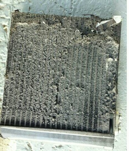

Ok let's talk Lancer stuff again,...
Just changed the evaporator in my car, was doing some research,.. The car never came with a cabin filter for the AC, but you can put in one yourself, apparently most friendly AC men have no idea that this could be done. Bought the filter for $75 by maraj air condition. Installed It in myself, so easy even a caveman can do it. I recommend you guys get one, else your evaporator will look like the picture attached. It's cheap, easy, an it will save you big in the long-run. Air will be a lot cleaner cause I used to get a scent sometimes.

S]<uLLeR_DAN wrote:Ok let's talk Lancer stuff again,...
I need to do this....
I changed evaporator twice and it never looked like this (no air filter in my CS as well)
You sure the absence of an air filter caused this?

I used to get a really bad scent with the blower alone Bcuz my ac wasn't working...now that the ac is working, the scent went... I'll check the evaporator to see if it's dirty.

Postby ZeroOne » February 17th, 2015, 8:23 pm
The bad scent is the result of a leaking evaporator, the gas/system is designed to smell like that to indicate that the evaporator is leaking and needs changing.
wow twice in your CS2 :?:
lots of mitsu models didnt come with a cabin filter, but there is place for it
Yep, even the blower was dusty,... An twice, wow... My car doing 260k over 10 years old, living where does have real dust an pumping AC right through an I now change mine. But yea it is the reason,.. How it's made up you can see how the dust reaches there. Changed mine myself.

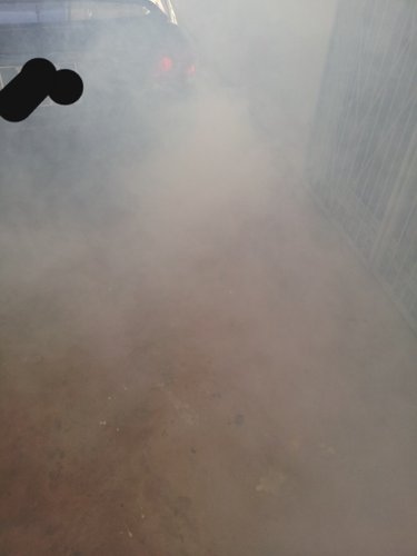

Yeah fellas, last week I changed oil, plugs and filter but a few days after a thick cloud of smoke comes out when I start it in the morning. I carrying back by the mechanic to check but I want to know what you think might be the problem

Re: The Official CS Lancer Thread!
Postby turbo_beast369 » February 20th, 2015, 7:51 am
Nidish wrote:Oh I see. The plug seals are these?
http://www.amazon.com/Md339118-Cylinder-Spark-Guide-Mitsubishi/dp/B00HCP1XJI
Are these compatible for CS3 4G18? Should I take the rocker cover to replace them? OR should I replace the camshaft seal?
I have already ordered Denso Iridium IK 16 :D
Those plug seals are compatible for both SOHC CS2A 4G15 & CS3A 4G18 engines.
I suggest you change the rocker cover gasket and plug seals in one shot. There are kits sold in
parts places locally containing the rocker cover gasket & plug seals so you should get that. Leave
the camshaft seal alone if it's not leaking. Don't interfere with it unless you doing a full timing
