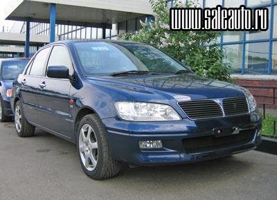

Looking for fogs like that guys, anyone can help me out?
if u know the model number for the fogs leme know plz. thanks

Fogs look good
