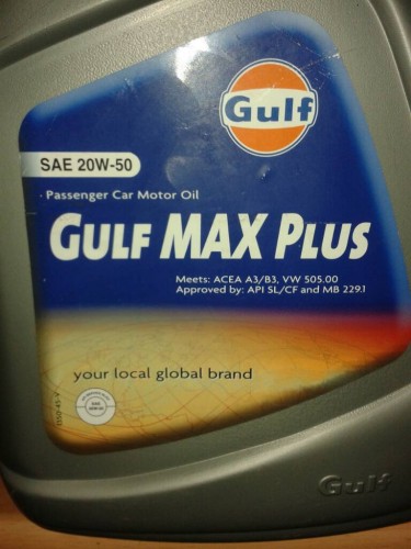

Thanks bro.... anybody ever use gulf engine oil. By padna say it real good. He hav a Chaser wit a 1jz ... wat bout cs

Postby ZeroOne » October 24th, 2013, 9:34 am
ngk is OEM, use that
I like to have new oil in my engine all the time so I change oil regularly, I use NP 10w30
