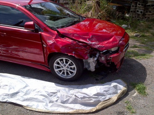

MitsuDiamonds wrote:Dude, if u're insured with Tatil...no probs at all.
With a Mitsu, they will take care of everything. Jus let them handle it. They will let u bring the car in to the repair center and thats it.
As opposed to a regular garage / straightner, etc who is not trained to repair those laners....doesnt have the maunals for that type of vehicle.
Correct matching of paint, etc.
I am with Tatil. Still waiting for word from the Insurance company however that excess is a beyotch though.
fras

Re: CY lancer (08 lancer)
Postby lancer 10 cy » June 12th, 2013, 7:08 am
this is how it looks, i need help/advice anyone thanks in advance
metalgear2095
Postby metalgear2095 » June 12th, 2013, 8:31 am
Nasty
Posts: 18946
Postby Dizzy28 » June 12th, 2013, 10:40 am
lancer 10 cy wrote:this is how it looks, i need help/advice anyone thanks in advance
Postby venum » June 12th, 2013, 11:05 pm
looks nasty
if u can get a front cut buy it
sell backl what u dont need
Postby lancer 10 cy » June 12th, 2013, 11:29 pm
thank, trying to source one, awaiting confirmation... i told them its a japan make but after doing some research i saw that cy2a came from sinapore
Postby lancer 10 cy » June 13th, 2013, 12:18 pm
Gosh...ah real feeling for you there. I carrying mine in tomorrow too repair (same colour too). The ANSA place in Chagaunas sourcing everything and doing the repairs for me though.
lucky you, i guessing your insurance fixing your car, unfortunately for me they wrote off mine and that money is d bank own so i back to scratch, on d bright side at least i have my car and i find the ppl who sourcing parts etc... taking long to respond or confirm i really dont have the patience, i feeling to just oder the parts off amazon but i not seeing the model of my car there so i afraid that it might not fit right and dont even know how much would be to clear everything from off d port, my mind just overworking cause i dont know the proceedures sighzzz
Postby JUS4SHO » June 13th, 2013, 12:18 pm
lancer 10 cy wrote:thank, trying to source one, awaiting confirmation... i told them its a japan make but after doing some research i saw that cy2a came from sinapore
Just to clear up
The CY2A is manufactured in Japan but not sold there. The reason for that is the lancer (CS) is still sold. The cy2a Is marketed else where as the lancer ex 1.5. Except in the US The CY2A is actually a 2.4. Why? I don't know.
Have u identified the parts you need?
Postby lancer 10 cy » June 13th, 2013, 12:38 pm
JUS4SHO wrote:Just to clear up
yes, i have a list here, but its from a first inspection so when i do start fixing i might see other issues that need addressing. i have no pics if u wanna tek a look and i can post the list of parts required
Postby idlemind » June 13th, 2013, 12:41 pm
lancer 10 cy, call Bella 6827179.
He has a few CY's in his scrap yard.
He isnt a parts place, but you may be able to get everything you need.
Postby JUS4SHO » June 13th, 2013, 12:52 pm
Bella is the lancer man. He buys crash cars and fix. He also has or can get what you need. When u call tell him Ryan gave u the number.
Postby lancer 10 cy » June 13th, 2013, 12:58 pm
thx a mill will call him
