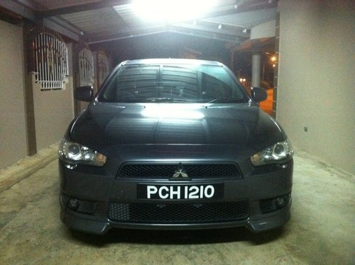

Selling d 2008 lancer,1.5 fully loaded (hid, sunroof , oem body kit etc) 69000km , mint condition. $135,000 neg. If you all know anyone Intrested. A few off the extras.
K&N drop in
Ultra racing upper strut bar
RPW rear sway bar
Oem floor mats
Oem black front grill
Oem Evo x number plate mounting bracket includes all oem hardware (not installed)
Oem front and rear mudguards
Pioneer AVH-p8400bh head unit with double dash kit with video bypass
Greddy rs exhaust
Full service history available.
