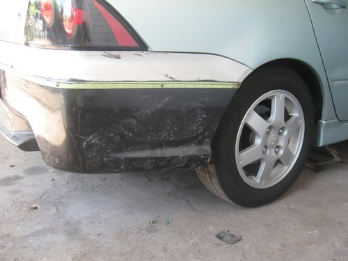

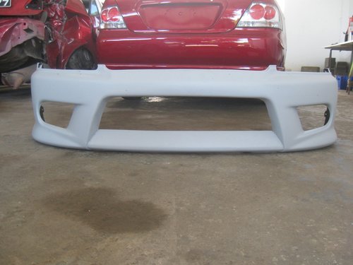

hey if anyone is thinking about doing the ralliart conversion on their cs here's an idea of how the back would look, its not finished yet but thats basically how it is, it looks a bit beird how the car high but when i lower it again it would look better,
also i did some mods to the front to relocate the number plate & the bumper looks totally different now

how did you do the F&R Bumpers? u used the Original CS2 bumpers and modified it, Got Ralliart Wagon Bumpers or Fabricated/fiberglassed a frame?

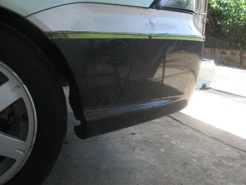

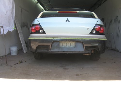

@ exodus i bought the complete ralliart kit, for the front i just cut of the square piece for the plate and made a flat piece and welded it back onto the underneath and
for the back i cut the top off a original bumper and did the same to the ralliart one and i welded the top of the original bumper onto the bottom of the ralliart one so that everything will bolt & clip on like normal
@ sound boy 64 i do plastic welding at our garage and i also have a excellent fiberglass man so u can msg me if u like
