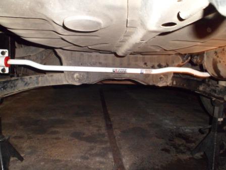

pics of maria's 19mm rear sway bar install ...... brackets were made by ansil ali
QG
Posts: 3545
Joined: July 18th, 2006, 9:56 pm
Re: CS Lancer!
Postby QG » September 6th, 2012, 8:57 pm
look cool!!!

Postby turbo_beast369 » September 6th, 2012, 9:36 pm
where they got the sta bar end links from?

Ignorant Ignis wrote:pics of maria's 19mm rear sway bar install ...... brackets were made by ansil ali
Install looks great!

turbo_beast369 wrote:where they got the sta bar end links from?
Chuna's Auto Spares and Accessories in Charlieville

María brand and price please

[quote="turbo_beast369"]María brand and price please
its the ck/cb links
part no. MB-518780
paid $120 for the pair

Nice job Maria...next stop I told you is the H brace. Can't make dex this Sunday but I'm sure I'll hear how it performed. Good luck!
