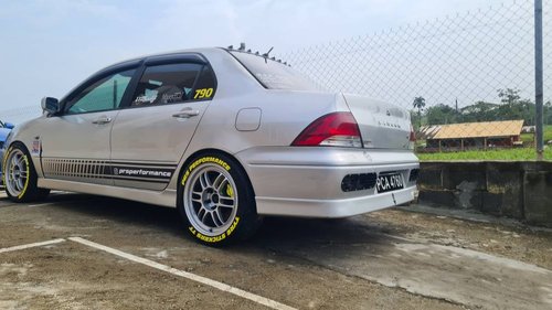

droppa wrote:Good day, wish I had looked for this thread sooner
So I swapped my CS3 from 4 hole to CS5 5 hole and 4-wheel discs. Adding to this some Enkei tarmac evo rims and 225/45/17 sailuns.
Car look good everything nice, but was I wrong about that combo, car squats and the rear fenders scrub like crazy.
Did fender roll, used H rubbers, set camber a bit more negative and still, to realize it’s the bumper tab and bolt causing the issues.
Anyone ever fixed this issue
17x8 with 225/45 scrubbing
What's the offset of the wheels? I'm running 225 45 17s with 17x8 +35 offset and no rubbing. Fender were rolled of course
