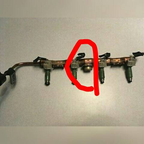

One more thing:
I changed the entire injector railing using injectors from the NZE 121(green colour), these have more holes in the tip as compared to the ones on the original altis(grey colour)... could this cause any issue?
Also, does the fuel rail have any internal pressure valves or is it hollow? As I noticed between the two injectors on the rail there is a circular crimped sort of thing ( see picture attached), What is this?

That looks like a pulsation damper.

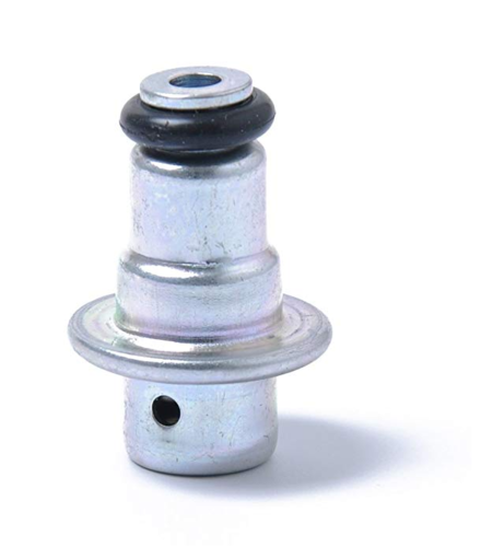

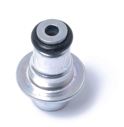

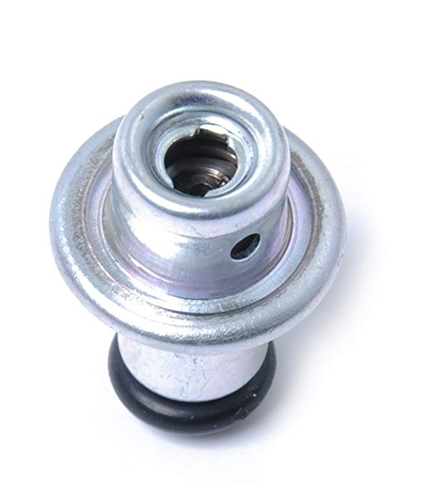

I did some checking, and saw that in the assembly fitted in the gas tank, there is a regulator. Because my car has the 2ZZGE engine, the Toyota part number is 23280-22010. On Amazon it is US$50.53.
There are lots of aftermarket brands as low as US$6.10. It looks pretty simple, and possibly the O-ring goes bad.
I will talk to my mechanic.
