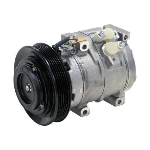

The issue for the valve going bad is not contaminants or oil breakdown. This is a sealed high-pressure system. Nothing can get in to contaminate.
I have a 15-year old Fielder with freezing AC. Never did any repairs except change cabin filter. I am doing 174,000kms.
AC repairmen give the public a lot of s--t, as the average John Public do not know how a refrigeration system operates. Always want to change your drier and expansion valve at every whim.
The compressor in question is always turning, once the engine is running.
The solenoid operated valve is fitted in a port that links the suction and discharge of the compressor.
When the AC is not operating the valve is open, suction and discharge are linked, so the compressor "floats"..........It is not doing any work.
When you turn the AC on, the valve closes, and the suction and discharge are isolated from each other. The compressor starts to work, and the blower blows air through the evaporator inside, which is cooled.
The thermostat setting controls the opening and closing of this valve, to cool or not to cool. OK ?
In the older cars the same electrical signal that would operate the solenoid valve, was used to turn on and off, an electromagnetic clutch on the compressor. With AC off, the belt would just turn the pulley alone, which would be "idle".
When you turn on the AC, the electromagnetic clutch would go "clack" and couple the pulley to the compressor shaft, and the compressor would start to work. Inside the car cools.
The opening and closing of the solenoid valve promotes wear, just like your pipe tap in your bathroom opening and closing every day. And yes, even though the gas contains oil it will still wear over time. Too, like in any valve arrangement, the seat surfaces where the o-rings seal against (which would be the compressor) can wear too. If you travel to POS from SFdo on a normal weekday, you would be surprised to find out how many times that valve opens and closes.
Personally, I feel that if you can retrofit the electromagnetic clutch-type compressor, you will have less heartache. And don't go looking for some B-11 Sunny compressor. Go for something from a more modern car if you are going foreign-used.
Compressor F/U is about $2500 these days.
The Clutch-type compressor has proven itself reliable, and the solenoid type has conversely proven itself with failures. Ask anyone with a Corolla about 5 years old, and they will tell you about failures.
Still, I have two links below from Amazon which possibly can be the valve.
Peace.
RR.
https://www.amazon.com/XtremeAmazing-Co ... dpSrc=srch
https://www.amazon.com/New-Compressor-E ... dpSrc=srch

A lot of technicians now fabricating brackets and installing some sort of cheaper nissan ac compressor.
Not the best option, but I've seen a few and they work pretty fine once done correctly!

Is this the compressor being used to replace the one with the troublesome internal valve on the 2008 Fielder?

Since no one answered my question I went ahead and took the chance and got the compressor pictured above and it worked out great. It's a direct bolt on, the only modification needed was to heat the clamp on one of the lines and turn it around plus slightly straighten out the same line a bit. Although the pulley is bigger the same belt works on it thanks to the wide range of adjustment available. It looks like a factory installation and that's what I was hoping for. I'm enjoying constant cool breeze again.
During my research however, I came across a possible cause for the premature failure of the solenoid valve. The original one fails after about 8 years due to normal wear and tear, but the replacement valve could be failing too quickly because of the lubricant our local a.c. technicians are using whenever they do a repair. These new compressors use polyalkylene glycol (pag) based lubricant, whereas our techs are still using polyolester (poe) based lubes. Both are miscible with r134a refrigerant but the two oils themselves don't mix with each other. When they come into contact with each other paraffin wax forms and that is capable of fouling the solenoid valve. I'm no a.c. tech, nor am I a chemist, that's just what I came across while reading.

While my compressor was being installed a woman with a 2 year old Kia Sportage came in to have her gas pressures checked. The a.c. tech told me he had to replace her evaporator a few days ago ..... 2 years old, imagine that. My co-worker had to replace his Nissan Sylphy evaporator after 3-1/2 years. he bought his car new from Massy. Some components on these new cars just aren't as durable as they need to be.
