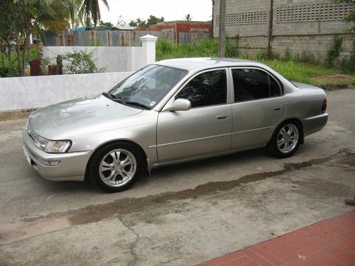

I wanna go up on tyre size from 195/50/15s to 205/50/15s (more tyre surface = more grip) but i wanna get some feedback as to whether the wider tyre touches in the rear or in front (my rear fenders are rolled though.....)

how much body roll you got? if a lot, stick with the 195s in the back and run the 205s in front and raise pressure on race day to save sidewall.
205s all around is mad understeer, ran that setup, now I'm back on 195s all around. ae111 with n/a 3s and lowering springs

i dont recall getting really bad body roll, ........but then again i have only raced using some donated 185/55/15 tyres in front and my Kumho 195/50/15s in the back.
