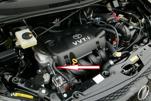

hey guys ,
anyone ever had to change the oil sensor ..idk if thats the correct name for it buts its a small sensor to the left of the engine
splingy

It's a vvti controller

eel7 wrote:What is the problem you're getting?
its dripping oil like a drop or two per day .. was told is the seal in the controller but i cant find the seal to buy neither the entire controller... do u guys knw any place i can get it .. called Toyota but the said they restocking the seals and stuff in january

All the NZE i see leaking oil from there .........

Postby bt50 » November 19th, 2013, 8:51 am
What I did was take out the sensor and put grey silicon around the seal and all leaks stop. When I got new seal from toyota I did likewise and no leaks to this day...almost 2 years later.
