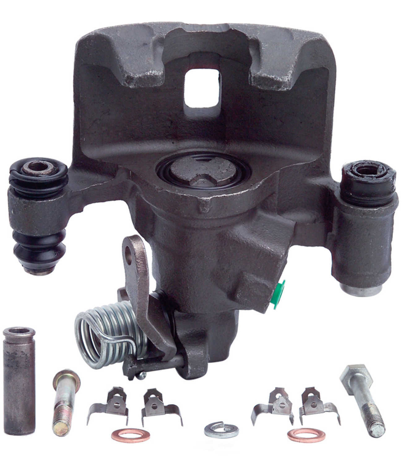

A couple months ago, I had the back of the car up in the air. Out of curiosity, I tried to turn the rear wheels by hand and one was fine, while the other actually turned with some effort.
Vehicle is a 1993 AE101 Corolla with the non-abs rear disc brake conversion done.
I'd always noticed that my e-brake never actually stopped the car, but rather slowed it down gradually. It worked fine on most inclines, but not all. No, biggie. I simply took out my handy rear piston adjustment tool (see pic) and adjusted both sides until I got what I wanted, then adjusted it at the handbrake cable end.
Now it appears as though they need adjusting AGAIN.
I inspected the cables and there doesn't appear to be any signs of stretching. The ends don't extend far outside the sheath to suggest that. But the adjustment at the handbrake end is at maximum, so if anything needs turning again, it's from the piston end.
Am I doing something wrong somewhere?
How do I inspect/repair the self-adjustment mechanism?

The one that doesn't carry brake shoes on the inside of the hat, so the e-brake is spring-loaded. Brake pads are new.

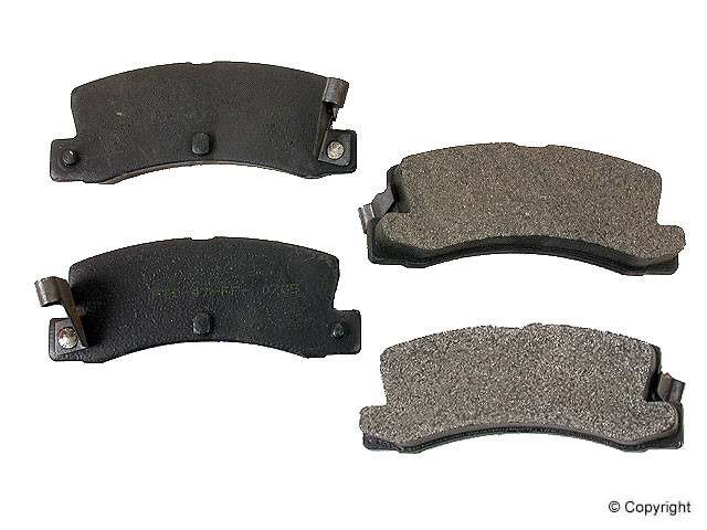

I think it's the pads. Only brand I found them in this rounds was OHK. The Akebono pads they came with had a small tab at the back that was supposed to fit into the groove of the piston to prevent the piston from rotating and thus retracting. The OHK pads don't have the little tab at the back.
I marked the piston position this time so I'll know if it rotates next time it feels loose...unless it makes a full rotation.
If any Camry SV20 (Gracia) owners know where to get rear disc pads with the tab at the back as shown below, lemme know ASAP.

Hook wrote:I think it's the pads. Only brand I found them in this rounds was OHK. The Akebono pads they came with had a small tab at the back that was supposed to fit into the groove of the piston to prevent the piston from rotating and thus retracting. The OHK pads don't have the little tab at the back.
OK! Didn't target correct assy and now assuming BZG Levin assy it appears the challenge may start from pad set to reqment to service full assy and refit new spec. pad and do reset adjustment procedure.
In terms of pad set you have enquired about I sure can help and will pm accordingly.
