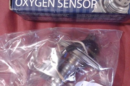

Postby Hook » May 10th, 2014, 6:07 pm
Ok, so it's a dread bump, but this is interesting enough.
This dude managed to find a compatible sensor with a flange and the only catch is swapping the plug casings, which is pretty easy to do. I'm at the end of my second used sensor, which is experiencing a VERY slow closed-loop swing (probably 5-6 times a minute), so it's time to replace it, and I plan to use a new sensor this time.
I'm not doing the whole grounding thing though, an incomplete heater circuit will trigger a CEL.
It's here!
