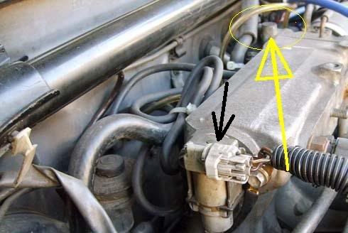

Postby Hibrydsoul » May 9th, 2012, 7:56 pm
I burrowed this from a page and I wanted to ask just for confirmation, the TPS is the cylinder shaped device pointed out by the black arrow, correct?

Postby Hook » May 9th, 2012, 11:08 pm
nope, the TPS or throttle position sensor would be connected to the butterfly valve/throttle plate assembly so it could detect throttle position/angle

Ok the device I was referring to with the black arrow pointed to it is the IACV. Does anyone know where I can get this?
