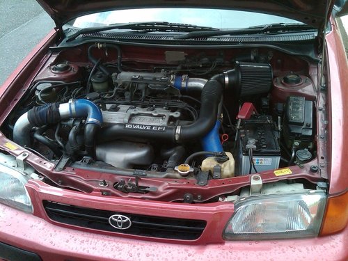

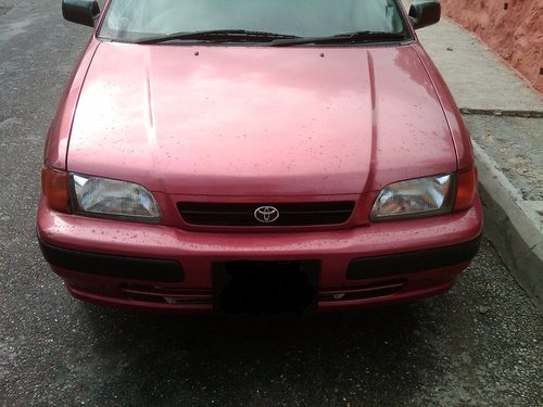

Postby Hibrydsoul » March 8th, 2012, 8:49 pm
Here are some pics of my car. There's still work to be done on her before I can say she's perfect but she is almost already. My second wife :lol:

Postby turbohead » March 8th, 2012, 9:06 pm
does these engine bolt on starlet bays or modifications?

Re: My Starcel
Postby Hibrydsoul » March 8th, 2012, 9:12 pm
Bolt for bolt

Re: My Starcel
Postby Hook » March 9th, 2012, 8:07 am
VERY clean install dude! well done!

Re: My Starcel
Postby reddo_tuner » March 9th, 2012, 3:41 pm
wow, I'm jealous :), nice clean engine bay bro, so whats the future mods list....

Re: My Starcel
Postby Hibrydsoul » March 9th, 2012, 6:47 pm
Thanks reddo_tuner, I wish I could say its all my doing but actually I bought it as it is. Future mods shortlisted for now is converting the rear drums to disc brakes, installing a strut bar as well as a sway bar. I wanna maintain the "sleeper" look so not much will be done. I'm pondering of switching out to the 5E-FTE as its a simple swap also and more power :evil: ..... That's all I can think of for right now. I'm still awaiting the full specs from previous owner as to what he did and did not do. I'm new to this so I need that list from him. Cosmetics..... changing them doors to powered, importing projector headlamps and LED Taillights and trying to source this http://www.tunersdepot.com/Exterior/Sid ... -8880.html Anybody know where I can get these? they are not in production any more it looks like :(

Re: My Starcel
Postby bigchief3679 » March 9th, 2012, 8:49 pm
Is the 5EF-TE swap really that easy? I think there's a little more to it...

Re: My Starcel
Postby Hibrydsoul » March 9th, 2012, 10:12 pm
bigchief3679 wrote:Is the 5EF-TE swap really that easy? I think there's a little more to it...
not really..... seeing that the 5E was used in the Tercel as one of its stock engine options... (maybe not in T&T) but elsewhere. The only difference is the turbo and all its accoutrements and seeing that the 4E-FTE fits so nicely in my vehicle, I would imagine that the 5EFTE will also.
There is actually a thread on here showing lastminuteaudio's 5EFTE Tercel's engine bay.

Re: My Starcel
Postby bigchief3679 » March 20th, 2012, 6:07 pm
You have to mix and match parts between the 5e-fhe and 4e-fte to make it reliable and boost friendly.

Re: My Starcel
Postby lastminuteaudio » March 27th, 2012, 10:14 pm
yeah hybridsoul, u can boost d stock high comp engine, d compression ratio is like 9.8.1 stock, jus gotta use back ur 4efte electronics on it, an possibly sum sort of management to retard timing & add fuel since ur using a larger displacement engine an injectors and ecu mapped for a 1300cc engine, not sure which intake manifold u gonna use but is a matter of ur choosing, if u use d FHE one, ur gonna hav to drill an tap a hole for ur intake temp sensor.
things u will need from ur 4efte: oil relocator on d filter, power steering tensioner(will need sum minor mods with the longer block) 4efte distributor or 5efhe, both are the same, sump pan & oil pick, rocker cover since it has a larger port & maybe a few other fine things...
use d fhe cams as they are slightly higher lift..i measured myself...sum ppl use d 5e timing mark an sum use d 4e mark...i used to 4e mark on mines...do sum googling an u will find all d info u really need....i personally scrapped down my 5e an rebuilt it wid all new parts one time(rings, bearings,seals, headgasket cause it was a foreighn used engine an will eventually need work, so i did it in advance...its ur choice....hope this helps
