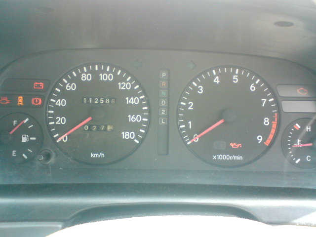

Postby dmitc » May 5th, 2008, 6:15 pm
gear changes at about 6800-7200rpms max
if there is a way to get it to change higher let me know
Hook
Posts: 13225
Location: The 6%.
Postby Hook » May 5th, 2008, 6:24 pm
:lol: soooo...ur redline is where? 8000rpm?
notice we said "redline" eh, not "rev limit" :idea:
BTW, if ur tranny has the "PWR/MAN" switch wired in, u can shift higher manually, tho you'd be at ur peak HP anyway *shrugs* unless u modded...
dmitc
Posts: 623
Joined: December 19th, 2007, 11:02 am
Location: Barataria
Postby dmitc » May 6th, 2008, 11:15 am
redline is at 7800rpm
believe the rev limit is 8200rmps not too sure

u have the 9krpm tach from a GT or wha?
dmitc
Posts: 623
Location: Barataria
Postby dmitc » May 6th, 2008, 11:54 am
yip

dmitc wrote:redline is at 7800rpm
my bad apparently redline is 7600rpm
well to tell yuh the truth hook unless yuh getting a man with a front half to sell yuh it i don't know where yuh would get one

Hook wrote:u have the 9krpm tach from a GT or wha?
my car does swing 9000RPM
orginal BZ touring with black top

i start to redline at 8000RPM
