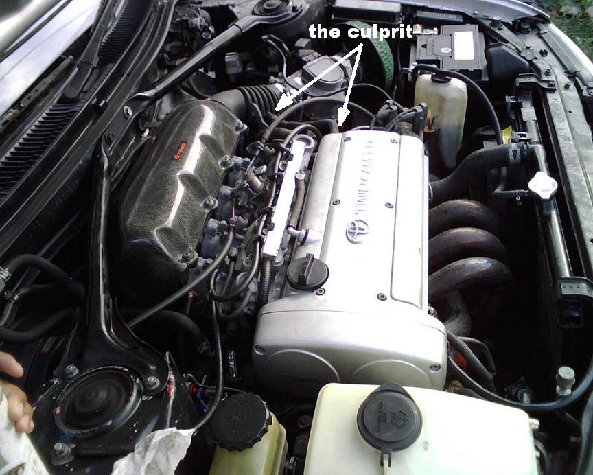

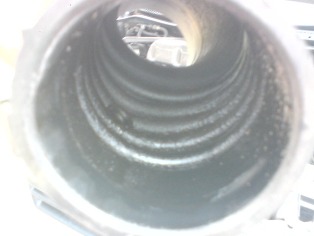

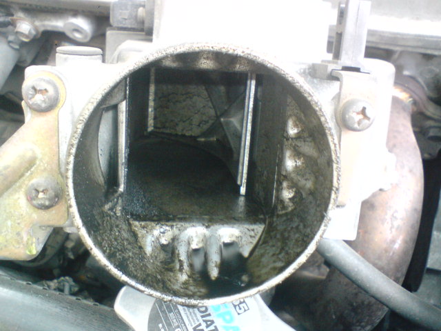

ok so i went to clean out my intake weekend and was met by this in my AFM
i know it is oil from on the tappet cover but what would cause that to happen?
Zeriam
Posts: 3195
Joined: May 6th, 2006, 2:39 am
Location: Couva
Postby Zeriam » May 6th, 2009, 10:11 am
suggestion.
oil catch can 2xx-3xx
some hose and a 20oz coke bottle could work 2 :mrgreen:
Postby eliteauto » May 6th, 2009, 11:18 am
dmitc, that's blowby caused by high RPM runs, the solution is to install an oil catch can
