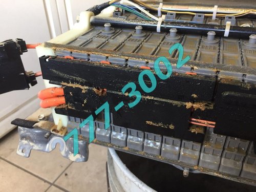

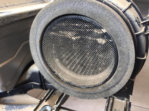

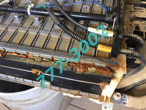

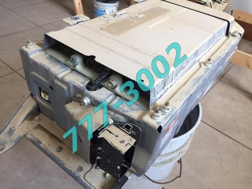

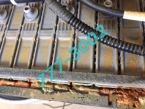

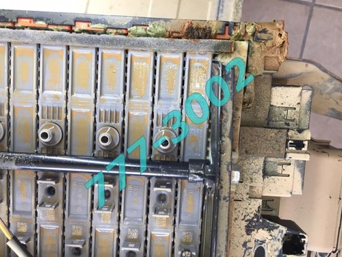

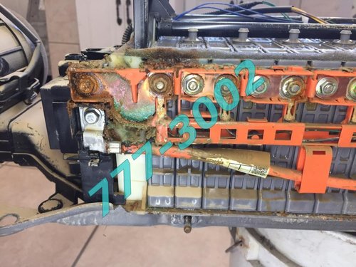

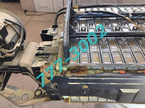

Just an update since we having all this flood.
this is what happened to a Toyota hybrid that was flooded and submerged.
The entire battery pack needs to be removed , opened and cleaned.
THE BATTERY PACK IS NOT WATERPROOF
DO NOT ATTEMPT TO START YOUR CAR IF IT BECOMES SUBMERGED TO THE EXTENT THAT THE HIGH VOLTAGE BATTERY IS SUBMERGED
The phone number in the pic can be contacted if this happens

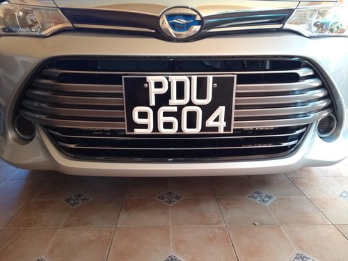

Hello Folks.
Got the registration last Friday.
Did a few things.
Painted the front grille with a metallic gunmetal.
Added a strip of the same paint under the rear windscreen.

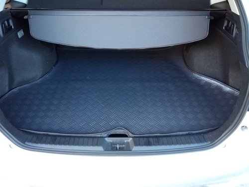

Made a waterproof mat for the trunk.

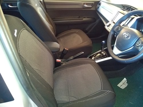

Bought some seatcovers.

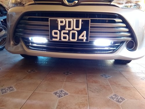

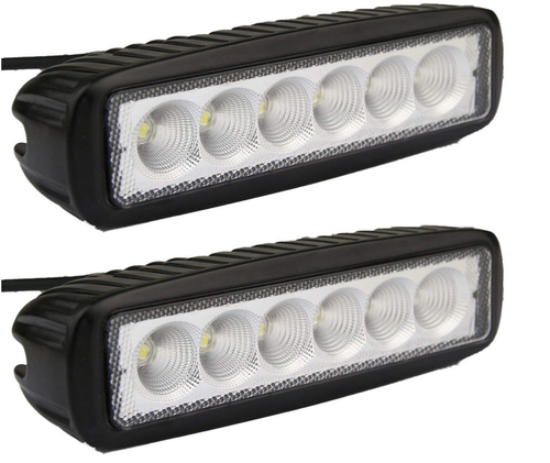

Added some DRLs behind the Grille.
Ditched the Inflator kit and got a doughnut.

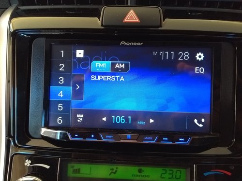

Installed a Pioneer unit. The Japanese Pioneer was a very sophisticated unit, but alas................................
Insured today.
Owner gets it tomorrow.
Peace.
RR

It is called "corrugated". Radica's Upholstery Supplies on Cipero St.
2 feet 2 inches. TT$125.
Mikey's charged TT$40 to cut it, and sew the piping around it.
There is a ready-made universal in auto-supply stores for TT$350 upward.
Cut along marks to fit.
Rubber.........too heavy.
The front is original cut pieces of 3M Nomad. Dansteel La Romain. TT$200 each.
The back is half-the-price Taiwan imitation. TT130 per foot. Dansteel.
The front will last forever.
The back has less service, Does not do well for front service.
Both catches dust and pebbles well.
Shakes off. Power washable.
Spin-dry in your washer.
Peace.
RR.

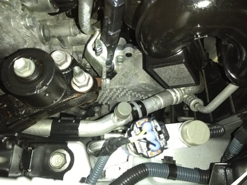

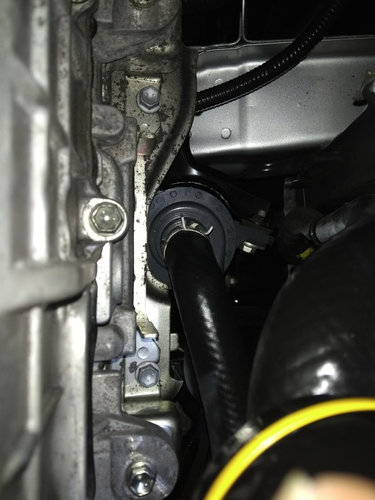

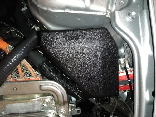

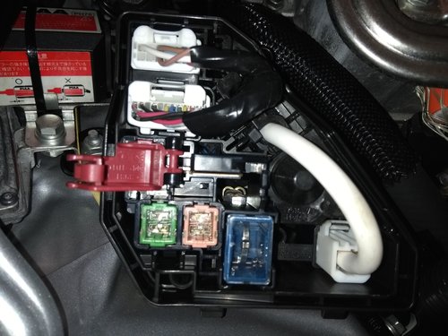

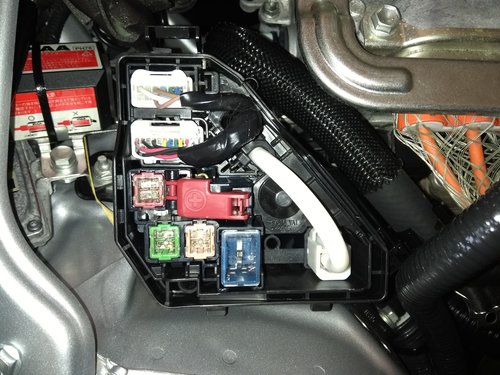

HOW TO JUMPSTART AN AQUA, FIELDER OR AXIO HYBRID.
The entire vehicle electrical system is 12V run by a SPECIAL 12 V Battery under back seat on the right side.
The High Voltage battery pack under the back seat, the transfer cable to the Inverter/DCtoDC Converter, the cables to and from, and including the Motor Generator 1 & 2, & The AC compressor is all High Voltage.
The current from the battery pack (HV DC) is converted to 3-phase AC to drive Motor Generator 1 which starts the engine. Motor Generator 2 drives the car. When turned, Motor Generator 1 charges the HV battery pack via the Inverter/DC to DC converter.
The control board inside the Inverter/Dc to DC Converter controls everything on the car.
There is no starter or alternator or mechanical water pump or mechanical steering pump. There is no belt.
Since everything is controlled by a 12V current, if the LV Battery (12V) is extra low (even though the HV battery pack is in great condition) there is no control and the car cannot start.
1. Locate the Fusebox on the passenger side just in front of the left shock mount.
Peace RR.
ramishrrr
Posts: 894
Joined: September 17th, 2007, 6:21 am
Location: Marabella
Re: Hybrid Fielders and Axio specific
Postby ramishrrr » October 30th, 2018, 4:31 pm
2. Remove cover.
Peace. RR.
ramishrrr
Posts: 894
Location: Marabella
Postby ramishrrr » October 30th, 2018, 4:33 pm
See the red cover marked + in the middle ?
Raise it up.
Peace.
RR
ramishrrr
Posts: 894
Location: Marabella
Postby ramishrrr » October 30th, 2018, 4:38 pm
It covers a black plastic stub with a copper strip that faces the windscreen.
Clip your jumper cable POSITIVE to this stub, making sure that the clip jaw that has the cable attached is touching the copper strip.
The NEGATIVE jumper cable can ground on any major part of the car or engine.
Start your car. (See READY light on the dash)
"START" here, means that you power up the 12V system, not tumble a starter motor. Once the system is powered up the controller board in the Inverter/DC to DC Converter takes over. The engine does not necessarily start. If the engine has to start, power from the HV battery pack will go to Motor/Generator 1 to turn the engine. You have no control over that.
DO NOT UNDER ANY CIRCUMSTANCES GIVE A JUMP TO ANOTHER CAR FROM YOUR HYBRID!
The terminal in the Fuse box was not designed to handle that kind of current, nor the white cable coming from the LV battery.. But most importantly, the heavy discharge of the LV battery could have devastating effect on it, or the sensitive electronics of the control system.
The engine running will charge the HV battery pack, not the LV battery (12V). The DC to DC Converter will take HV DC (about 200+ VDC) from the battery pack, break it down to about 14.5VDC to charge the LV Battery. You have no control over that. But of course, your ignition must be ON.
The White wire in the fuse box brings current from the LV battery (12V) to supply the car. You will notice it is no really heavy gauge wire. This is because the 12V needs of the car without a starter motor is pretty small. No heavy cable is needed.
Your LV battery must not be charged externally with more than 4.0 amps for no more than 10 hours , with a special AGM battery charger. Do not replace the battery with a non AGM (Absorbent Glass Mat) battery. Doing anything otherwise can damage the battery and the electrical system.
Peace.
RR.

ramishrrr wrote:It covers a black plastic stub with a copper strip that faces the windscreen.
Peace.
RR.

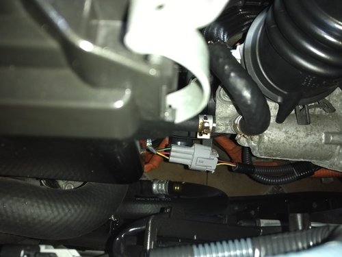

SO YOUR HYBRID HAS TWO RADIATORS !
Yes folks. 2 separate crossflow radiators in one frame.
The upper, which is the larger radiator with larger hoses cools the engine. If you follow the radiator hose on the right side of the car, you will see it goes to the electric Aisin water pump. The photo shows it with rows of cooling studs on the outside. The coolant goes through the block, then the head, and comes out on the engine side close to the Inverter/Dc to DC Convertor. Too the coolant, by means of smaller hoses warms up the throttle body, and the brake module atop the engine. Also there are linework/hoses to and from the cabin heater. The coolant reservoir seems to be attached to the radiator by a port, as I cannot see an attached feed/bleed hose.
The first photo is the throttle body hoses.
The second is the Water Pump. Notice the rows of studs.
Peace.
RR.
ramishrrr
Posts: 894
Location: Marabella
Postby ramishrrr » October 31st, 2018, 8:50 pm
The second radiator, the smaller, is below. It has smaller hoses.
The Inverter coolant pump (see photo) is in front, under the Inverter. It pulls coolant from the bottom of the reservoir, sends it to the right side of the radiator. Coming out from the left side, the coolant goes into the Inverter on the engine side. It exits on the left side and enters the reservoir at the top. There is no thermostat in this system, as all the heat generated by the Inverter/DC to DC Converter must be removed.
Peace.
RR
