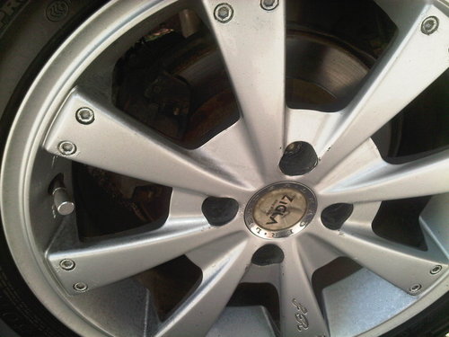

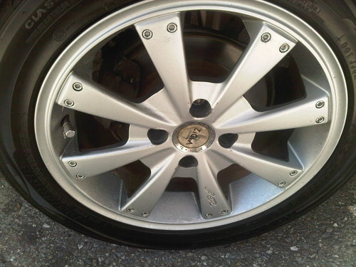

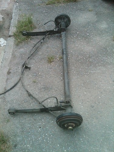

Postby Hibrydsoul » October 13th, 2012, 8:52 am
So here are the pics of the ep91 banjos installed.
Bye bye shield......
in with the discpads!
Out with the drums

good job on the install guy....but whats the performance like? Also, wouldn't you have to now change you mc to accommodate this upgrade?
Hibrydsoul
Posts: 277
Joined: August 23rd, 2009, 8:13 am
Location: Pushing the limit.
Re: My Starcel
Postby Hibrydsoul » October 13th, 2012, 12:49 pm
didn't have to change anything.....and as for performance..... it works beautifully.

:lol: the sleeper look disappears once u have rear disc brakes...strangers does see mine and ask "20valve nuh?" :roll:
good job on the install bro...u did it yourself?
Hibrydsoul
Posts: 277
Re: My Starcel
Postby Hibrydsoul » October 13th, 2012, 4:31 pm
Yeah me and a neighbour...... and its not that easy with them rims to see it so I still maintain a sleeper look :D :twisted: and thanks.... it was fairly easy save and except that shield :shock: that beech was indeed challenging.
