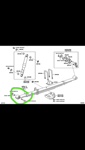

Question: I'm 46000 km in on a toyota Hilux 2014. After I did my first under wash I started hearing rattling and squeaking noises from the back of the truck which come and go.
My question is could they have something to do with worn bushings?
Also how long do leaf spring bushings last on average.

summitboyz wrote:Question: I'm 46000 km in on a toyota Hilux 2014. After I did my first under wash I started hearing rattling and squeaking noises from the back of the truck which come and go.
Those leaf springs are usually greased at the ends and lengths, as well as the joints throughout the length of the drive shaft.
Under washing would have washed off the grease as well as put water in some undesirable places.
I suggest that you get the springs greased and the drive shaft as well, before rusts sets in.
Another option is to have the suspension sprayed with shock oil after under washing.

Just an update I've isolated the squeak to one of the bushings.
Would that still be a shock oil fix?

Which bushing?
summitboyz wrote:Just an update I've isolated the squeak to one of the bushings.
summitboyz
Posts: 14
Joined: September 9th, 2011, 10:39 am
Re: Toyota Surfs,Hilux and 4X4s.
Postby summitboyz » May 15th, 2019, 7:02 pm
*KRONIK* wrote:Which bushing?
This one
Posts: 9325
Postby *KRONIK* » May 15th, 2019, 7:05 pm
That bushing dont usually go bad, especially on a low mileage vehicle.
The shackle busings are usually 1st to go.
Try some silicone spray on it.
