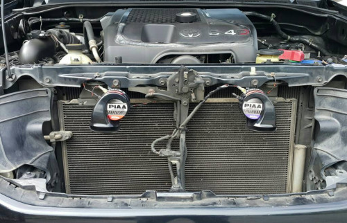

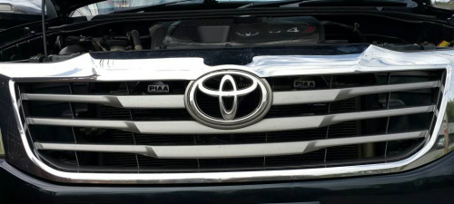

So i called my auto electrician...he say 450 to change the clock spring and 250 to change the horn.
Took a half day off from work.
And changed the clock spring in about 30mins total.
So now that i had an actual working horn....
I took the opportunity to install a pair of PIAA horns i bought for a previous vehicle.
Had to extend some wires but it was an overall simple install.
Saved 700 dolla

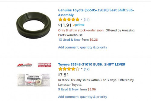

I am looking for the shifter bushing kit for my manual Hilux. I had shifting problems from stand still, difficult to shift into 1st and reverse gears. I took the gear leaver off and notice the shifter bushing and seat is worn. Toyota is out of stock.

SNIPER 3000 wrote:Good job,
Does this feel like a lil bite when going into 1. I does get a lil bite when shifting into 1 from stand still as well. Mechanic was like nah ur gears going in good. I still iffy doh. Did a brake/cluch fluid flush and thing.
Yep, a little bite, pretty soon reverse will need some effort. Remove the lever and check the bushing and seat.
easy 15mins.

Cool, will take a look. I am seeing the two bushings on Amazon.... But the part numbers from Amazon are interchangeable part numbers to the ones I got for the van via the Chassis number.

ADONI wrote:
SNIPER 3000 wrote:
easy 15mins.
So it should work? looks exactly like mines, going to order it.

Seeing this Euro site have the bushing and they matching it back to the Amazon PN and the PN for my 2007 Hilux.
http://www.euro4x4parts.com/parts/vsl10 ... 35030.html
http://www.euro4x4parts.com/parts/vsm10 ... 31010.html
