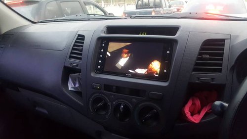

Got my Android deck up and running

Postby *KRONIK* » March 30th, 2018, 6:45 pm
PariaMan wrote:Got my Android deck up and running
Pics
Specs
PariaMan
Posts: 3741
Re: Toyota Surfs,Hilux and 4X4s.
Postby PariaMan » March 30th, 2018, 9:40 pm
Worth every cent ,runs android ,wifi,separate subwoofer Bluetooth and plug and play
PariaMan
Posts: 3741
Postby PariaMan » March 30th, 2018, 9:42 pm
Plus 45 watts per channel
