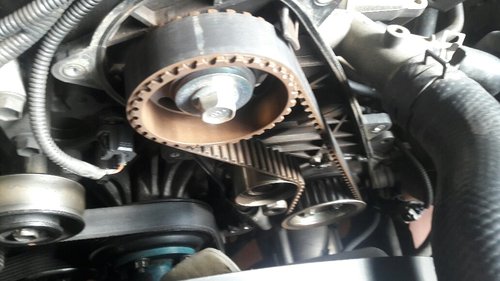

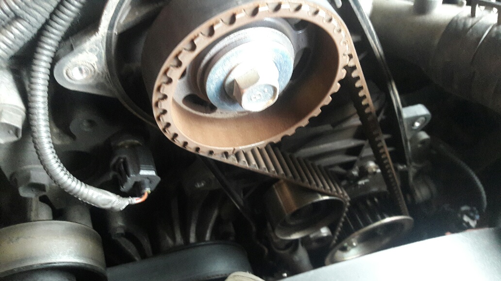

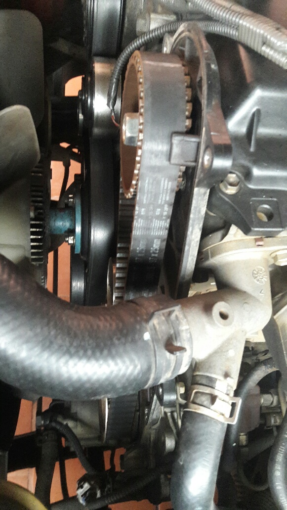

I opened the cover of the timing belt and it looks pretty good.
