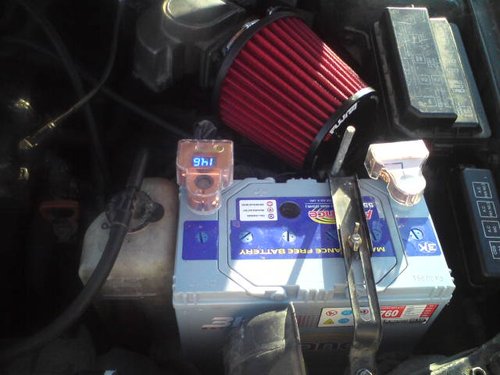

I also ordered a few other goodies for my baby hoping to collecting everything except the filter (should come in next week) by friday
ImageFujita F5-300S Super Flow High Performance Air Filter
wanted the Apexi 500-A026 Power Replacement Air Filters but that was twice the cost and my wife will kill me if she knew i bought the fujita in the first place :wink:

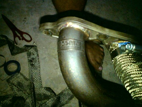

ImageDEI 010131 Titanium 2" x 25' Exhaust Wrap
ImageRaptor RGBTMP-4C Rose Gold Positive Battery Terminal with Meter (1) 1/0 Gauge (2) 4 Gauge (2) 8 Gauge Oututs &
ImageRaptor RGBTN-4C Rose Gold Negative Battery Terminal with Cover (1) 1/0 Gauge (1) 4 Gauge (2) 8 Gauge Out

CBharath wrote:woi woi . how much for the battery terminals and the air filter
filter US$40
Positive terminal US$14
Negative Terminal US$8
Still awaiting shipping and custom charges (hope it's not to much)
$790 in total
Customs $158 for filter $52 for terminals
Shipping $120 for filter $52 for terminals

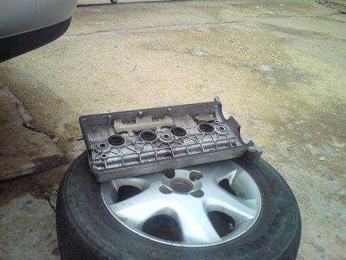

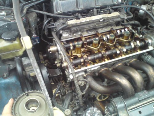

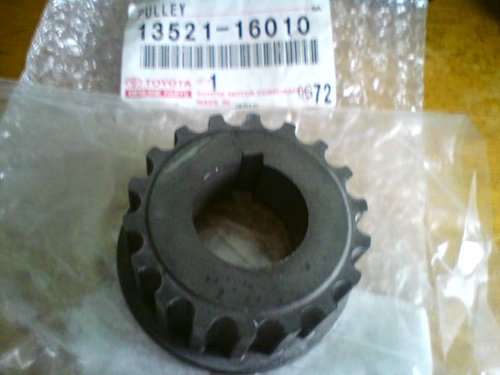

Postby dmitc » June 13th, 2011, 10:46 am
well she's finally up and running (not literally since the car is still jack up)
work done:
New cylinder head Gasket
New front seals (cams, crank and water pump)
New Water pump
New crankshaft Timing gear
New fan Belts
New Air filter
New Battery and Terminals
Heat Wrap for extractors
Fluid Change - Coolant, Powersteering and Oil (RP 15W40)
Replacement Power steering return hose
Replacement PCV Valve hose
Replacement Tappit cover and Coolant sensors
Cleaning:
Trottle body and stacks
AFM & ISCV
Power steering lines
Head and block
Oil sump pan
Some cost (what i can remember):
Tools - $600
Parts - $3180
Every thing else - $540
i'll post some photos when i reach home tonight

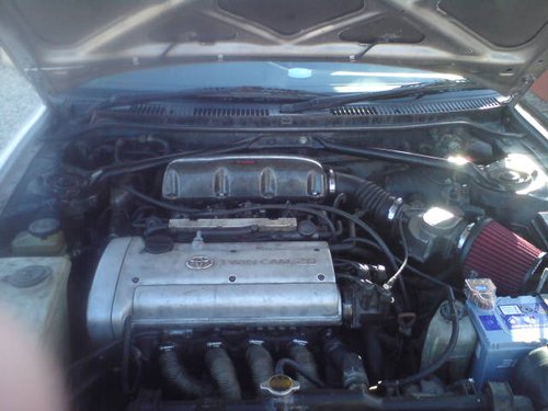

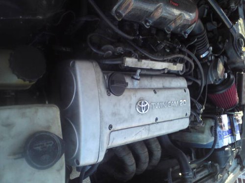

Here are some pics of the finish product
dmitc
Posts: 623
Joined: December 19th, 2007, 11:02 am
Location: Barataria
Re: The comprehensive 4age thread
Postby dmitc » June 22nd, 2011, 10:06 am
Update:
Car has been running for about 2 weeks now, no long runs since i only fixed the alignment monday plus I got in an accident week before, but i can say that the engine is a little louder than before, it seems to be running a bit more aggressively now though. i'm not sure if that is to do with the new filter and heat wrap but for sure the heat wrap have the engine bay relatively cool, even after short hard runs.
Only thing to do now is to fabricate a shield for the air filter so that when the rad fan comes on it does not blow hot air on it.
All in all i'm please with the results.

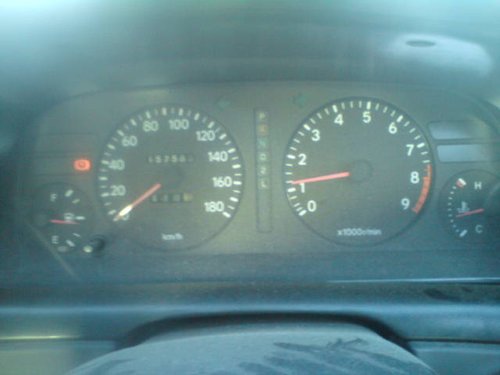

The O/D light flashing means there's a fault or an error code with either the transmission or the circuit controlling it.
Subject: 20V 4A-GE: Warning Light, Speed Sensor & ECT Diagnosis
Hook wrote:we learn new things every day folks...I recently had a problem with my "O/D Off" light flashing on my dash..here's the remedy
A self-diagnosis function is built into the electrical control system. Warning is indicated by the overdrive OFF indicator light.
Note: Warning and diagnostic codes can be read only when the overdrive switch is ON. If OFF, the overdrive OFF light is lit continuously and will not blink.
a. If a malfunction occurs within the speed sensors (No.1 or 2) or solenoids (No.1, 2 or 4), the overdrive OFF light will blink to warn the driver. However, there will be no warning of a malfunction with lock-up solenoid.
b. The diagnostic code can be read by the number of blinks of the overdrive OFF indicator light when terminals TE1 and E1 are connected.
c. The throttle position sensor or brake signal are not indicated, but inspection can be made by checking the voltage at terminal TT of the check connector.
d. The signals to each gear can be checked by measuring the voltage at terminal TT of the check connector while driving.
The diagnostic code (trouble code) is retained in memory by the CPU (of TCCS ECU) and due to back-up voltage, is not canceled out when the engine is turned off. Consequently, after repair, it is necessary to turn the ignition switch off and remove the fuse EFI (15A) or disconnect the TCCS ECU connector to cancel out the diagnostic (trouble) code.
Note: Low battery voltage will cause faulty operation of the diagnosis system. Therefore. always check the battery first. Use a voltmeter and ohmmeter that have an impedance of at least 10K Ohm/Volt.
Check "O/D Off" Indicator Light:
