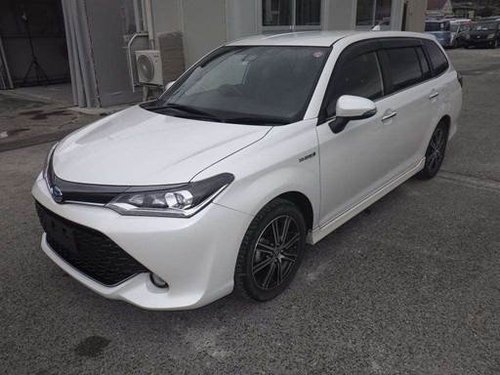

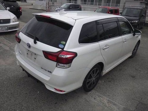

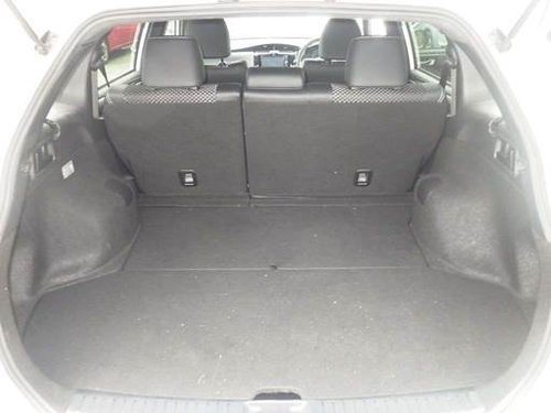

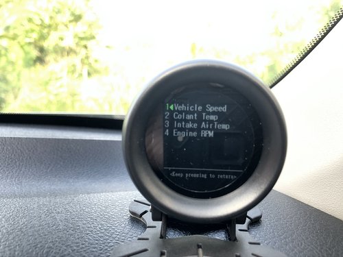

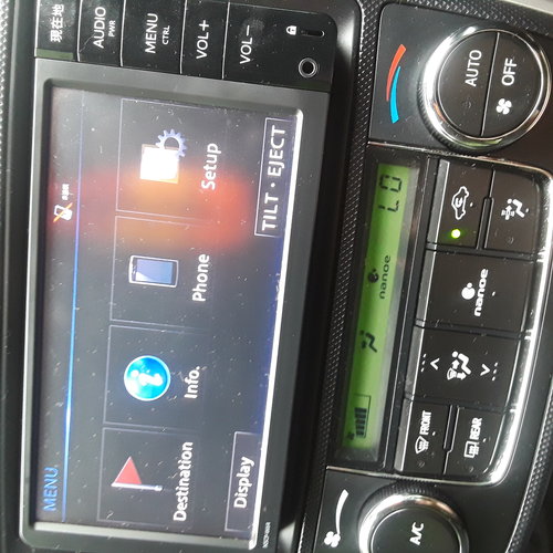

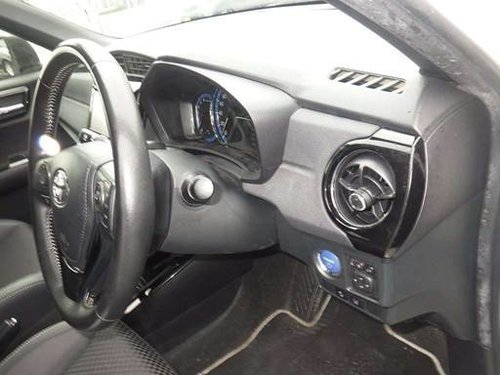

Confusing for uploading pics on this site. Telling me file to big. Anyways. Updates. New tires ended up being 195/60/15’s. 205’s would rub. Tires and rims plus spanner proof lugs, $3,700, Roston’s in Debe. Car rides better than original tires. Had original tires in back of car plus 3 people and no X 2 board. The cars lock is awesome. Gas mileage is insane.
Tried putting ordinal rim/tire in the back in place of pump combo deal. It’s doable but does not fit perfectly.
As far as D&D goes, they went through a check list with us that we had to sign with regards to the car. At 3,000km we can bring the car back for a oil change, no charge. Checked all oils/fluids and everything checked out. I will be checking the filter for battery/fan tomorrow. I find they went a little to far with the Armorall.
Carvx.jp to check for real mileage. It’s worth the money.
Wondering what the nanoe logo on the a/c was? Turns out some kind of kick ass air filter. Was wondering why I wasn’t smelling exhaust fumes right in front of me. Further testing required but so far so good.
I feel there are going to be a lot more of these cars, especially the Fielder sooner than you think. Get rid of your petro only car before is looses major value!

Postby venum » July 18th, 2019, 9:34 am

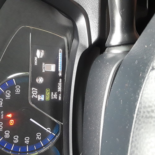

thanks for the pics, but nothing there was converted to english, its all english so from the factory
play with more menus and tell me if you see japanese or english

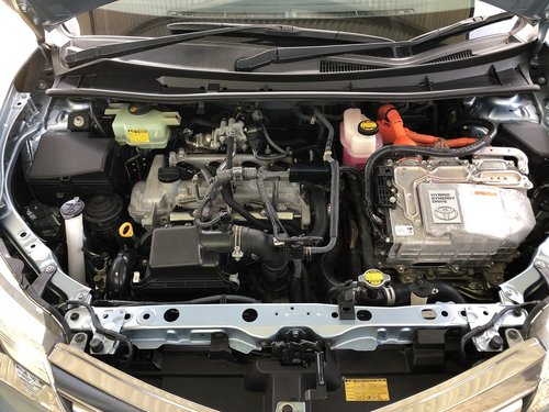

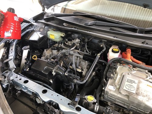

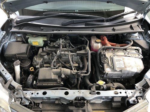

Did an engine wash last week. A FAHTT club member did it and it reall was done pretty good
BEFORE - 1 year since delivery, no washing or cleaning.
Steam cleaning
AFTER - Clean Engine
Contact Quintin 282-9434

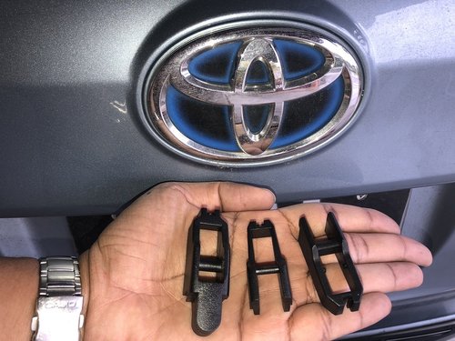

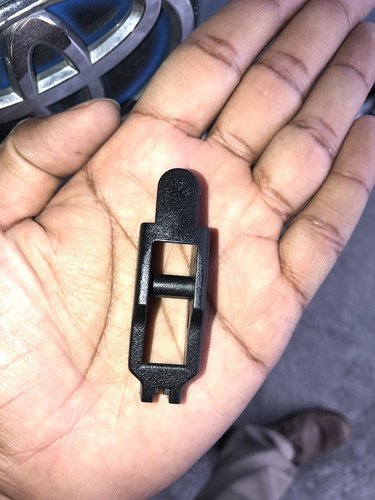

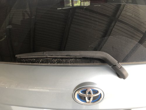

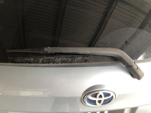

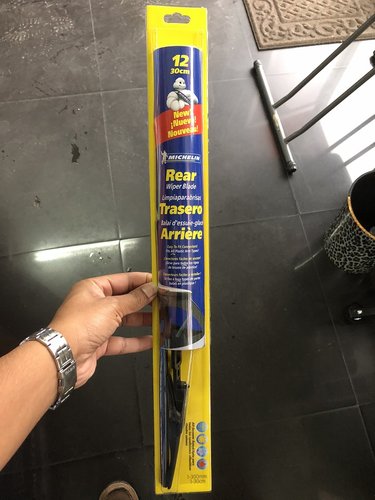

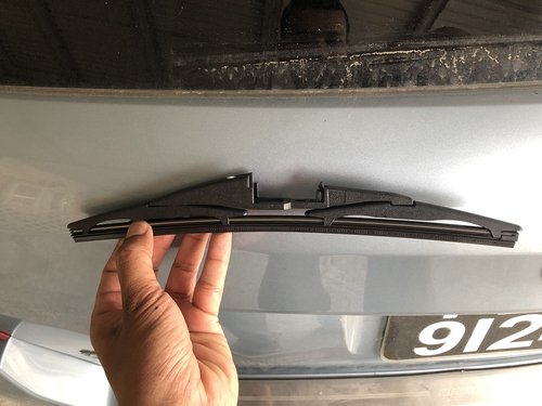

Installed new rear wiper blade, the one the car came with was wiping streaky and was worn, time to change.
OEM\Factory blade
New blade - $75
comes with 3 clips to suit various vehicles
This is the one we need
New blade installed
The Toyota Parts man Razi from South has OEM refills as well - 740-0614

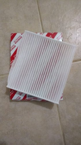

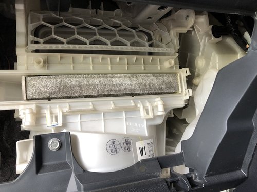

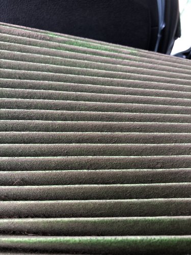

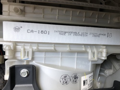

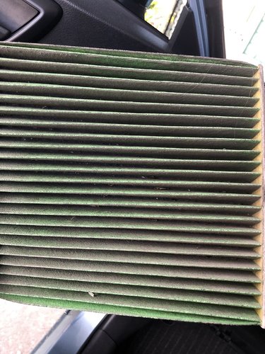

Changed the AC cabin air filter - IT WAS STINK
remove the glove box carefully to access the filter, is behind a white plate labelled top at one ent
take out and observe
replace with a new one, make sure and observe the air flow direction. air flow is top --> bottom
OEM available for $160
Razi 740-0614

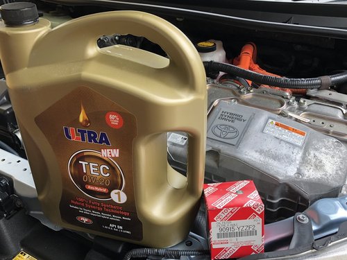

Tried the NP TEC 0W-20 oil this oil change

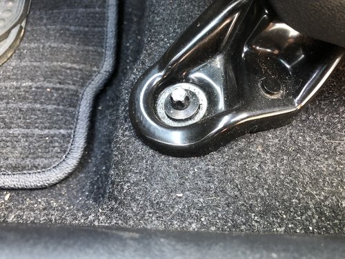

Socket to remove the front seats fro Fielder and Axio Hybrid and Aqua's
Torx E10
can buy loose or in a set.
$30 loose by Allied Industrial San Do

When push became shove, I used the ring end of a 8mm spanner.

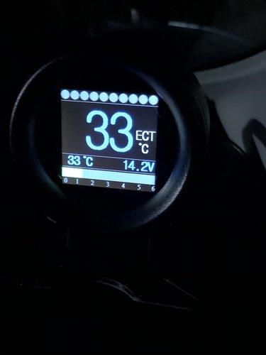

Postby venum » October 9th, 2019, 12:27 pm

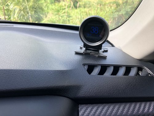

Since our cars do not have a temp gauge and me being a bit old school and wanting this, I bought and installed and AUTOOL X60 Car Multi-function Digital Meter
The gauge itself can do OBD 2 scans for DTC and is customizable to display different parameters
no major installation required, just install on your dash and plug into your OBD-II port, it uses the engine's coolant temp sensor.
you can configure it to do over-temp and over speed alarms
https://www.amazon.com/Multi-function-W ... B00YG8N2UC
