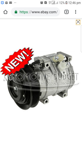

trinimark wrote:Since no one answered my question I went ahead and took the chance and got the compressor pictured above and it worked out great. It's a direct bolt on, the only modification needed was to heat the clamp on one of the lines and turn it around plus slightly straighten out the same line a bit. Although the pulley is bigger the same belt works on it thanks to the wide range of adjustment available. It looks like a factory installation and that's what I was hoping for. I'm enjoying constant cool breeze again.
During my research however, I came across a possible cause for the premature failure of the solenoid valve. The original one fails after about 8 years due to normal wear and tear, but the replacement valve could be failing too quickly because of the lubricant our local a.c. technicians are using whenever they do a repair. These new compressors use polyalkylene glycol (pag) based lubricant, whereas our techs are still using polyolester (poe) based lubes. Both are miscible with r134a refrigerant but the two oils themselves don't mix with each other. When they come into contact with each other paraffin wax forms and that is capable of fouling the solenoid valve. I'm no a.c. tech, nor am I a chemist, that's just what I came across while reading.
hello can u let us know what compressor u bought - assuming u bought it online & shipped it in yourself ?
i am going thru same ac compressor issues with my 141 fielder & to me rather than go pay for some old used over priced f/used compressor that may conk out after a while i rather buy something brand new
in case anybody wondering about d part no for compressor its ... 88310-52551
I modified and using the NZ121 compressor (bottleneck) and it works fine. Using it for over a year now, no issues. I think you can get this brand new locally. Maraj AC in San Juan.
much thanks for ur reply ... by chance u have a model number for it ? ... nowadays without a model number its hard to research or buy & i dont want to buy d wrong thing ....
That I am not sure of but this tuner also sells the compressor brand new. Give him a shout for further info.

Re: TOYOTA COROLLA AIR CONDITIONING ISSUES
Postby Rovin » September 12th, 2018, 11:12 pm
^^^ thanks man , will do
i did some goggling using a VIN no i found on youtube & i think d ac comp part no for NZE121 is 88320-1A481 ...
Hi, I have a Toyota Corolla NZE141R and the compressor needs to be replaced can u tell me if the following pic is the same compressor that u brought and would it work on my car
It's a Denso...thank you
