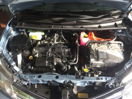

Good Day,
Creating this thread dedicated to Hybrid Fielders and Axios. The intention is to make it a one stop spot for all the hybrid Fielder and Axio information.
Basic Information:
[2013] Toyota has launched the Corolla Axio and Corolla Fielder hybrids in Japan.
On the styling front, the eco-friendly models are distinguished by a new grille, "Synergy Blue" emblems
There's also a 4.2-inch multi-information display and a "nanoe" ionizer that removes pollen by releasing "particle ions embedded in minute water droplets."
Both models are powered by a 1.5-liter Atkinson-cycle engine [1NZ FXE] that develops 74 HP (54 kW) and 111 Nm (81 lb-ft) of torque. It is backed up by an electric motor that has a maximum output of 61 HP (45 kW) and 169 Nm (124 lb-ft) of torque.
This enables the model to have a combined output of 100 HP (73 kW) and a fuel economy rating of 3.0 L/100km (77.6 mpg US / 93.2 mpg UK) in the JC08 test cycle.
The cars have also been equipped with a noise-reducing windshield and additional sound deadening material.
https://www.pakwheels.com/new-cars/toyo ... ifications
https://www.motor1.com/news/40449/toyot ... -in-japan/
Chassis Code:
The hybrid Fielder is the NKE165, the Axio is the ???
Official 160 Corolla wiki page:
https://en.wikipedia.org/wiki/Toyota_Corolla_(E160)
The ones we get roro are different to the local ones, which were the wider body and different face E170 model
Engine model: 1NZ FXE 1.5L (1496cc) Specs: 74 PS (54 kW)@4800 rpm, 111 N⋅m (82 lb⋅ft)@3600-4400 rpm
Transmission: P510 eCVT
The Fielder and Axio carry the same engine and Toyota Hybrid Synergy Drive system as the Toyota Aqua (Prius-C) so a lot of resources and information that is applicable to that car is applicable to the Fielder & Axio Hybrid
See here for the Aqua related thread:
http://www.trinituner.com/v4/forums/vie ... 2&t=704670

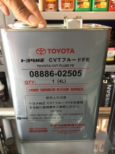

PART NUMBERS
1NZFXE Engine Oil Filter: 90915-10003, 90915-YZZF2
Engine Oil: 0W20
Recommendations: Toyota or Amsoil
P510 Transmission Fluid: Toyota ATF WS
1NZFXE Spark Plugs:
Toyota OEM 90919-01272
Denso FK16R-AL8 normal
Denso VFK16 Iridium
NGK IFR5T11
https://www.ngkpartfinder.co.uk/car_com ... p?id=17085
Air Filter: 17801-21060

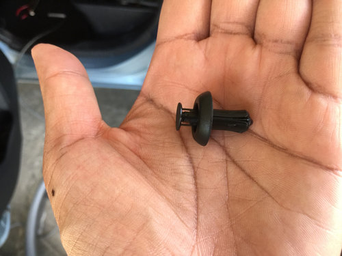

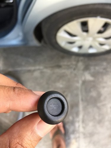

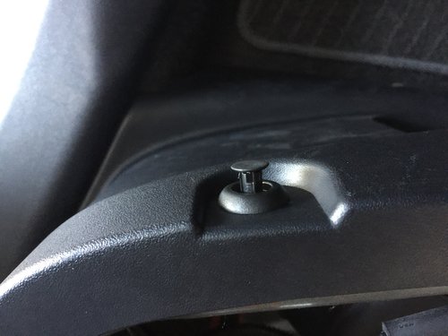

HV Battery Cooling Fan panel clip (Push rivet) 90467-08226
Related information:
CVT technology and eCVT technology differ greatly
http://www.winnipegsynthetics.ca/articl ... -ecvt.html
The eCVT found on the Toyota Prius and other hybrids differs from CVTs found in other vehicles, such as the 2013 Nissan Altima or 2012 Scion iQ, because it does not use a belt or chain connected to a pair of variable pulleys. Instead, an eCVT uses electric motor/ generators to control the speeds of planetary gearset components. This allows the eCVT to continuously change the gear ratio, keeping the engine’s rpm in the sweet spot. Just like when driving other CVT-equipped vehicles, drivers of vehicles with eCVTs don’t feel the step change common to traditional automatic transmissions, yet the mechanisms (planetary gears) to achieve acceleration are largely the same.

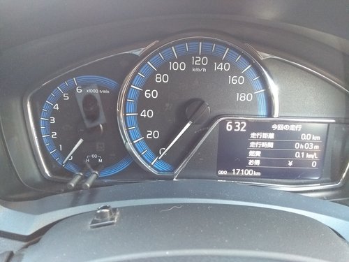

HOW TO PUT ENGINE IN MAINTENANCE MODE
To keep the engine running continuously without switching to EV, when doing engine work, e.g. coolant flush, oil leak inspection, checking for leaks etc requires that you put the car in Maintenance Mode
Models with key ignition
Turn ignition switch to ON (do not start the engine), instrument panel lights will light up, but should NOT say READY
Press the accelerator pedal all the way down and release x 2
Press and hold brake pedal for the rest of procedure
Change shifter P to N
Change shifter N to P
Turn ignition switch to START and observe the engine start and run continuously WITHOUT switching to EV
To disengage maintenance mode, just switch off the car - turn the key to the Off position
Models with PUSH START ignition
Press the Start\Stop button twice (don’t depress the brake and start the engine), instrument panel lights will light up, but should NOT say READY
TRC OFF Warning light will stay on and the display will show TRC OFF
To disengage maintenance mode, just switch off the car - push the Start\StopP button
NEVER DRIVE THE CAR WHILE IN MAINTENANCE MODE ! ! !
NEVER ! ! ! NEVER ! ! !
Toyota has warned that driving the car while the engine is in maintenance mode\continuous run will cause permanent and irreversible inverter damage
JOIN the FIELDER & AXIO HYBRIDS TT CLUB
https://chat.whatsapp.com/HE9GXyKk5tFCCkDrHCx0F9

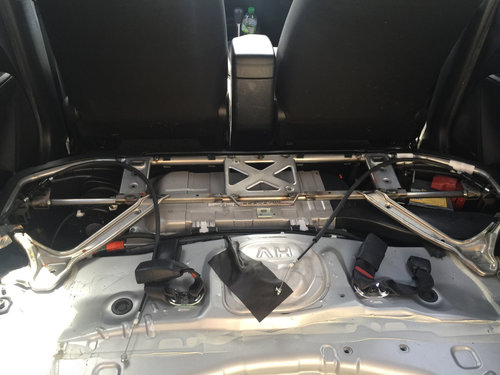

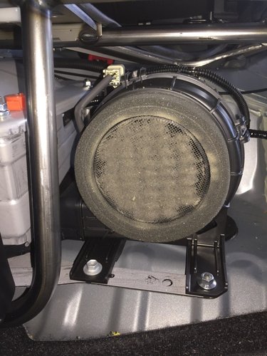

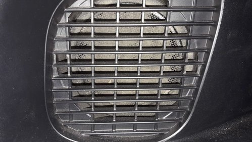

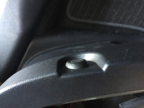

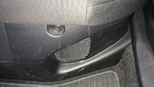

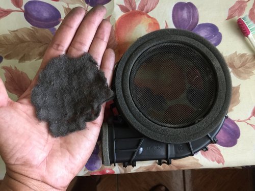

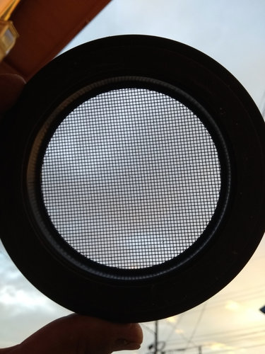

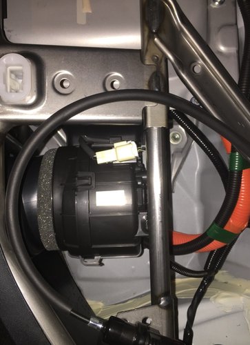

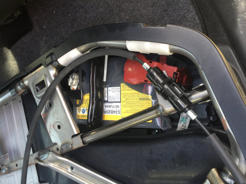

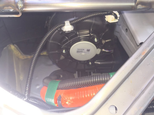

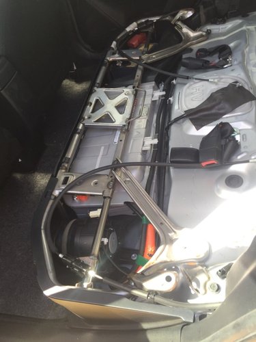

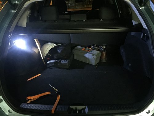

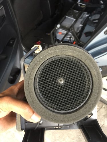

Electric Voltage (EV) components of the car:
HV\drive battery is under the back seat
right next to the 12V accessory battery
There is a cooling fan for the battery compartment that vents to the rear right side footwell. this is a maintenance item that needs to be cleaned periodically, every 6 months or so as it gets dirty

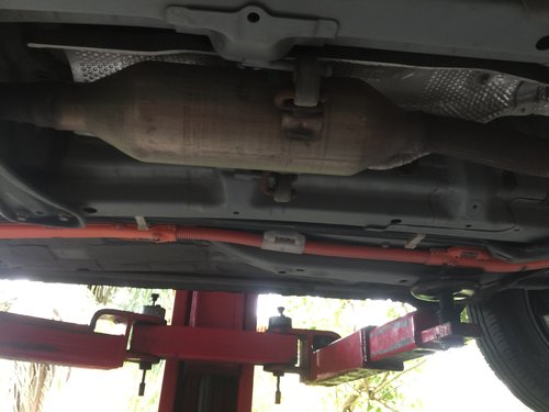

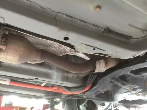

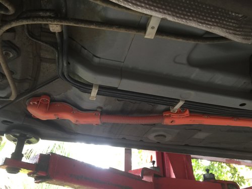

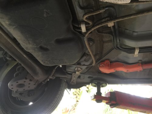

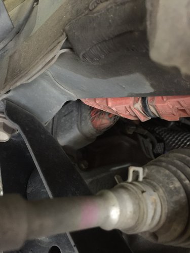

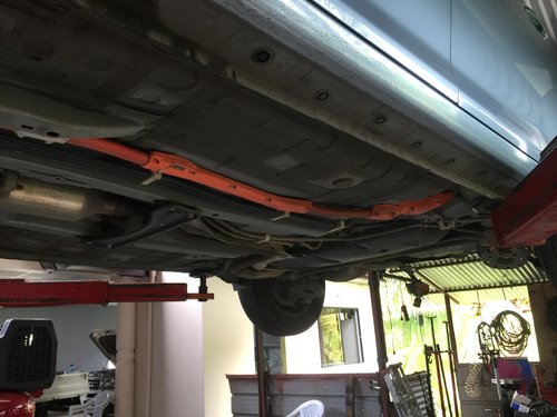

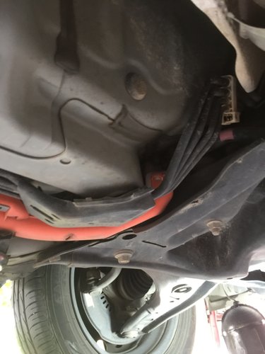

Underside of the car where the HV lines are installed
BE EXTREMELY CAUTIOUS WHEN JACKING UP THE CAR TO NOT DAMAGE THESE HV CABLES
esp all those hustle shop mechanics and tyre men, the cables are sufficiently towards the center of the car, but still withing reach for damage if a floor jack is rolled too far under the vehicle.

Good initiative, have a hybrid not a toyota tho, will still follow for information
What maintenance is recommended for the hybrid/battery aspect other than cleaning the cooling blower and associated ducting?

AFAIK, the battery is not a service item unless it has an issue like a bad cell(s)
you can run diagnostics on it to see if there are any weak or defective cells.

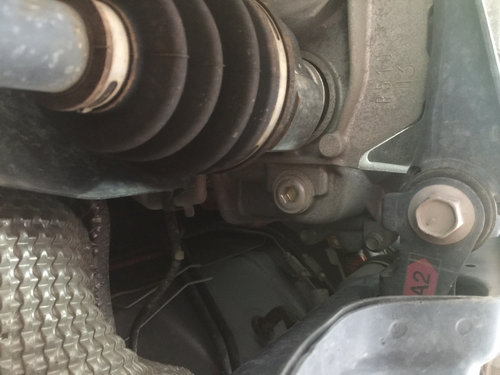

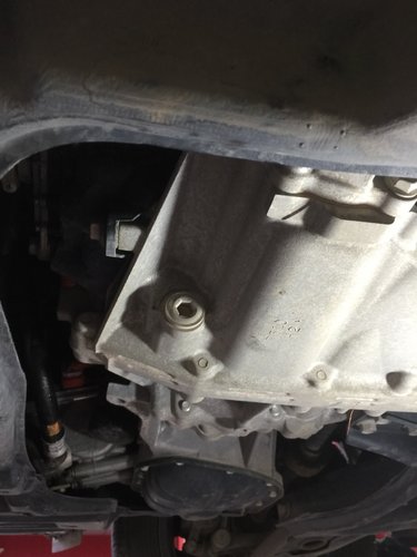

Postby venum » October 8th, 2018, 4:10 pm

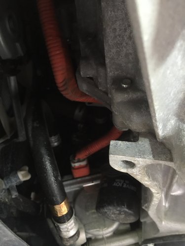

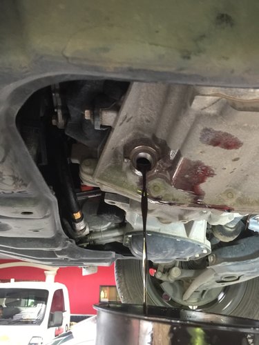

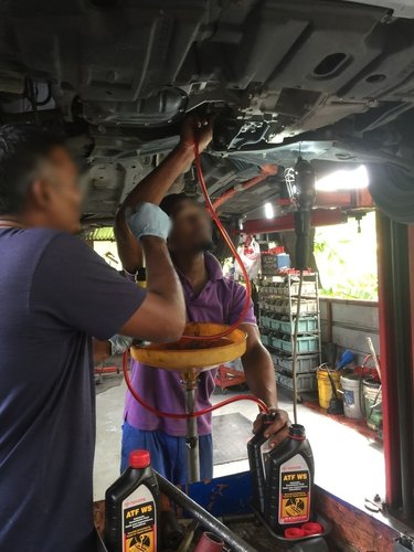

Did a tranny fluid change on my Fielder hybrid.
there is no dipstick in the engine to fill the new fluid, so you hadda change it like differential oil, drain and fill till it overflow from the fill hole
Drain hole. Outside (wheel) side of the tranny facing left side wheel\stone shield
Fill hole. Engine side of tranny just under the left side inner cv joint
drain out 3.5 qt when measured
Fill using an oil pump

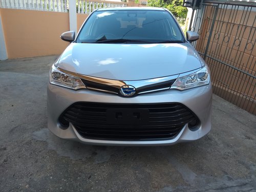

I have a 2015 Fielder coming in the country tonight.
It is the facelifted model with different front and rear.
I would have liked to get the 2015 G WXB, but LAWD IT SO EXPENSIVE !

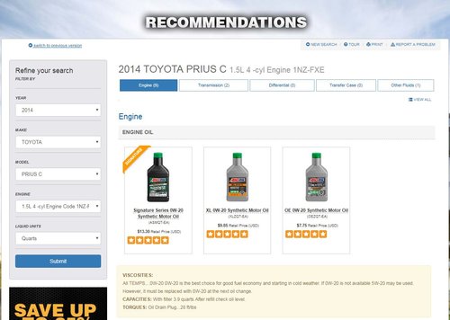

Why does everyone like recommending Amzoil? Amsoil is very aggressive oil and I am not sure that it's compliant with low SAPS that is required for these environmentally friendly vehicles with restrictive catalytic converters.
I'm a MANNOL reseller, but I'd recommend Gulf Formula ULE instead. Or Mannol Energy JP 5w30.

mostwantedDUDE wrote:Where locally you got the spark plugs to purchase ? Also the tranny fluid why is Toyota WS used instead of the TC fluid?
working on that spark plugs
Toyota recommends their WS. they have different grades of fluids out there, but that is what they recommend, Why though i would presume that for the design, friction requirements, heat dissipation parameters of eCVT the WS has the specification required
Krystal Car Part Imports wrote:Why does everyone like recommending Amzoil? Amsoil is very aggressive oil and I am not sure that it's compliant with low SAPS that is required for these environmentally friendly vehicles with restrictive catalytic converters.
I recommend Amsoil because it is what I use and have good experience with it in multiple other vehicles, both gas and diesel. there are many good oils out there. When guys use other brands and report back on their experiences, I will update the main post. Toyota recommends 0W20 and advise that 5W30 be used only when 0W20 not available, but only for 1 oil change, then switch back to the 0W20. I believe that is applicable to cold climates. The oil body can be debated for our climate, temps etc, but for me, in this thread I'm sticking to what manufacturer advises

Amsoil is very expensive oil and there are more cost effective alternatives. I'd always go for European made oils because they sell you exactly 1L over 946ml.
And I wouldn't be so quick to knock NP oils.NP ultra tech 5w40 is Mercedes Benz approved motor oil. You can check the Bevo website. The quality of their products has improved significantly. Usually failures proved to be caused by motor oil are covered by insurance.

I was in a presentation this week from NP on their oils and the approvals they have received.
personally, I am willing to try the NP 0W20 and report back

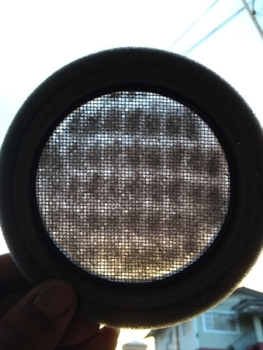

Here is the fan that needs to be cleaned periodically. it is the HV battery ventilation\cooling fan that pulls cool air from the cabin to the HV battery compartment
when dirty
Access from under the back seat, left side

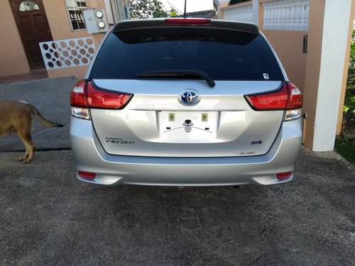

Got the car yesterday.
Pretty good condition.
Peace.
RR

OK guys and girls,
This weekend was oil change time, Amsoil 0W20 and the orig yota filter
then on to HV Battery cooling fan cleaning
Dirty fan
Clean fan

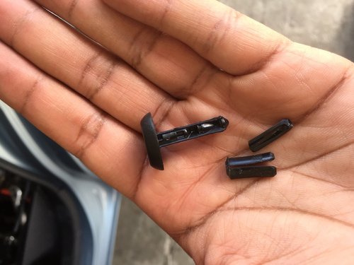

Careful with the clips when removing and re-installing the finisher.
I had a casualty
the correct way to remove is to push down the head then gently pry off
when reinstalling the process is to
1. push in the head
2. pull out the head, but not all the way
3. place in spot, take you time
4. press in the head to lock in place
now to go find a clip

Kevin_45 wrote:Also I do agree with your statement that reffed to the mileage of these vehicles, since I bought my car on auction I've seen the average mileage of all the cars so whenever I see low mileages one's selling locally it's just real sketchy. Anyway mine is came in at 50,xxx and the I also had the de registration certificate which confirm that .
This is what mine showed on the service sticker
Yet the dashboard shows 25,xxx km
knowing the real mileage is always very important

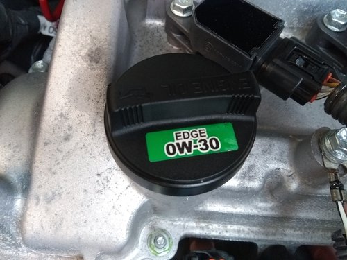

Venum,
Yesterday I took the Fielder to Licensing Office.
Adjusted rear brakes. Front pads OK.
Got the engine and transmission oil changed.
The filler cap on the engine had a sticker 0W30, so I replaced it with 0W30.
The transmission oil replacement was just as you said and did.
The mechanic (friend for decades) remarked that the fluids were in pretty good condition still.

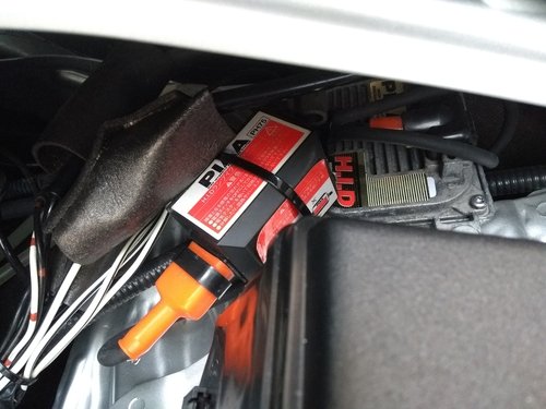

Have a Pioneer MVH-300EX to replace the fancy Pioneer Carrozzeria it came with.
Pity my daughter can't read Japanese !
The low beams are PIAA HID.
The high beam is normal yellow light (like that).

GT with those PIAA hid, wish they were available locally, I used to buy PIAA off amazon several years ago, but I find they too expensive for that now.
my G model has regular H4 bulbs but the headlight reflector does a great job of spreading that light, so I'm not gonna upgrade them. I just did LED inside
