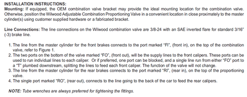

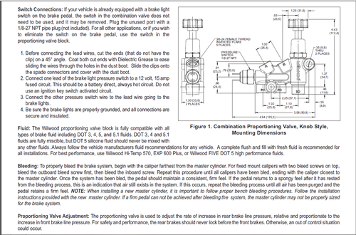

Can't you install one of those adjustable ones?
Ronaldo95163
Posts: 8393
Location: Not quite sure
Re: * Offical AE111 Levin Forum *
Postby Ronaldo95163 » August 8th, 2017, 11:30 pm
Ted_v2 wrote:Can't you install one of those adjustable ones?

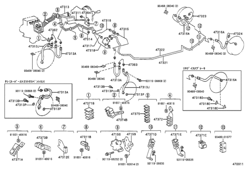

Was looking at the Wilwood adjustable one.
But will definitely have to make over my brake lines just to accommodate fitting it.
Not sure if I can run the rear off of the single Rear-out port on the wilwood either. AE111/110 has two brake lines coming out of the prop valve going to either wheel.

You probably will be able to run the rear of of the single port....I think they have an adapter for that.
