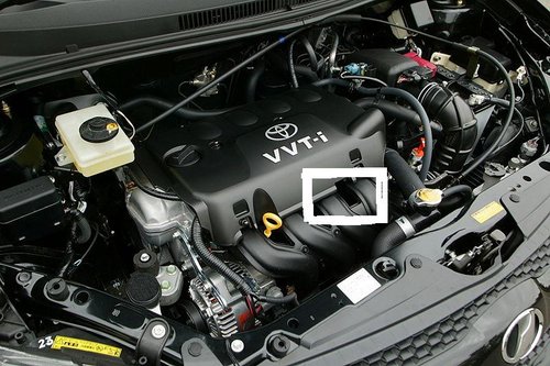

The 1.5L engine that the Corolla from 2000 got, as well as the Fielder, Allex, Runx, Probox, Platz, Vitz, Vios, Scion Xb and a host of other Toyota cars was the 1NZ-FE. The current Corolla & Fielder still carries it, though it may be with a drive-by-wire throttle. (No accelerator cable)
The engine type & number can be found on the cylinder head under the plastic intake manifold between nos. 3 & 4 intake. A flashlight may be necessary. Check the photo.
For 4 years we have been running our 1NZ-FE on super, very hard at times. No problems yet, even at 170KMH.
All this and other 1NZ-FE info were discussed before.
