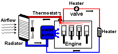

Postby scion I » May 26th, 2010, 4:51 pm
clarification of why you should not bridge the flow of the coolant but cap off the lines when disconnecting the cabin heater lines. So to those mechanics who say otherwise yuh know what to do!!!! :twisted:
Thanks Ramishrr and Hook!!!

Postby ramishrrr » May 26th, 2010, 6:25 pm
Scion I, yuh is ah rel Hero. Thanks for the diagram. Makes things easier for folks to understand.
It emphasises that, with the cabin heater and its control valve bypassed, there will be preferential flow. Rather than going to the pressurized radiator, the hot coolant from the engine will travel through the unrestricted bypass line to the suction of the water pump, (where there probably will be a negative pressure) and circulate back through the engine, carrying up the operating temperature.
Regards to you and Hook.
