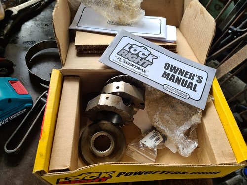

So I went in the diff, the needle bearing was the culprit. A few of the needles had froze in position and the inner CV was wearing its diameter. So I had to change the bearing and the CV.
This is what the bearing looked like.
Needle Bearing.jpg (4.33 KiB) Viewed 11588 times
Well, since I had to remove the entire diff, I went down Penal and picked up a lunch box locker.
I had also brought in some hubs and front disks, end up changing the hubs only and skimmed the rotors from the vehicle.
The outstanding item is the LSD for the back, went down Navet, but he did not have any, so if anybody know of one, let me know.
