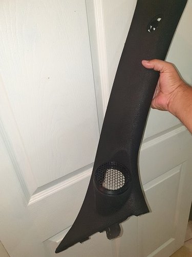

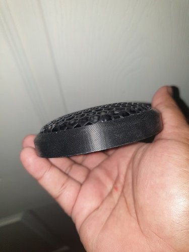

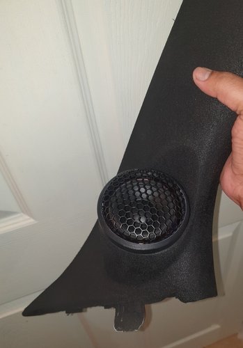

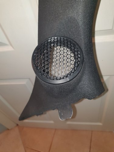

Work could have bee better finished but my dog decided to munch on them while they were drying. I was too tired to refinish them properly and that pointy end in the pic was eaten out by the dog so I had to figure out how to make it back from the scrap plastic that was cut out..... but still proud even though the finish easy to flake. Kren did the 3d printed ring and I pressed the grille.

Hope the damn thing fit after all that...

That dog of yours not easy lol. Looks great tho buddy, loving the fine details!

What's the coating, duratex?

duplicolor truckbed coating.... with a bit of black regular spray paint on top. Rough pattern when spot shooting from a distance. Experiment with distance.

I would try bumper paint....saw duplicolor in a store Arouca area. They had bumper paint, as well as the truck bed paint that I used. It holds up ok but was made for metal adhesion. You can see videos on YouTube. I would plastic weld, fill with body filler, sand and paint with regular satin paint so its easy to touch up when scratched. Bumper paint made for plastic and has a satin aka low sheen finish.

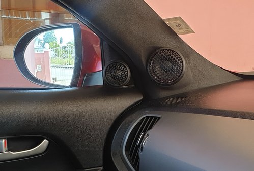

Left side fits well.... the right dog chewed side giving some pressure.

The tweets were installed a while now with no intention to add dash speakers. But when tuning with a cheap dayton mic, I was seeing huge cancellation from 400 to 600 that was not responding to boost. I added the 3 inchers since I keep reading that moving the mid range frequencies above the dash mitigates the cancelation. Manufacturer says they can play to 20000 hz so tweets might not be needed but they are sweet sounding. Did not want to do more work than needed and there is a clip location just above the 3 incher that cannot be cut.
