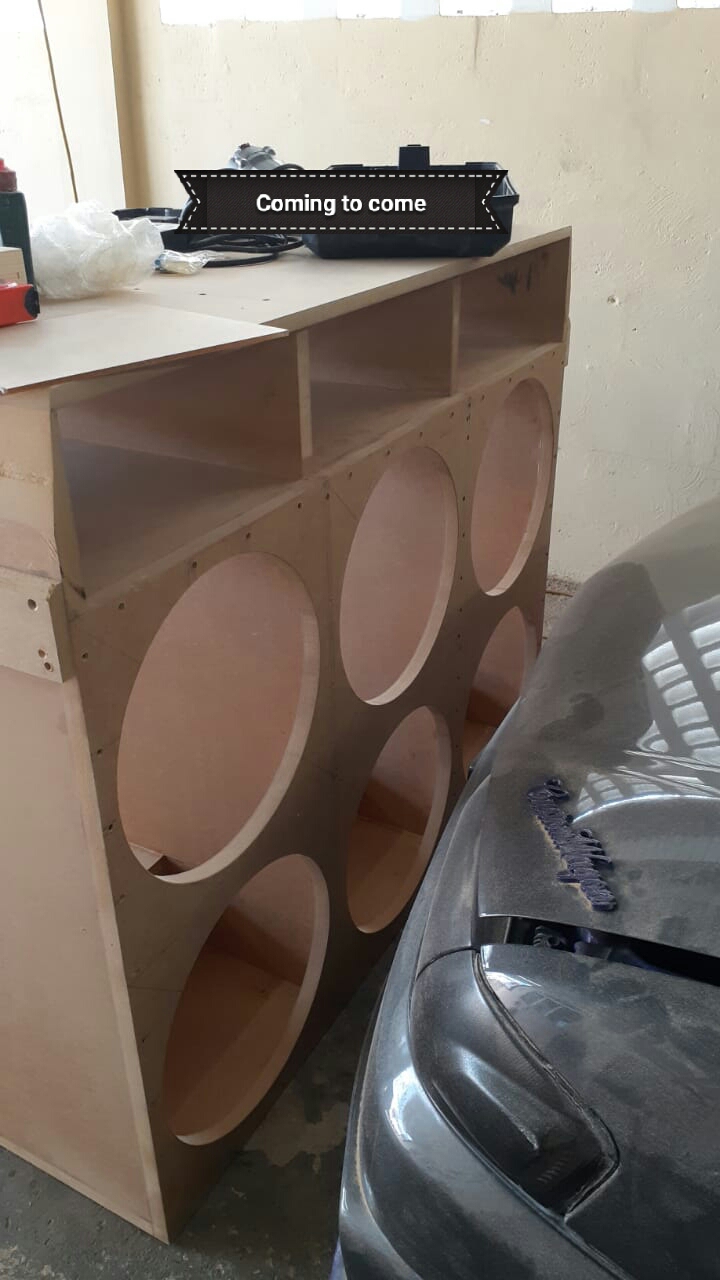

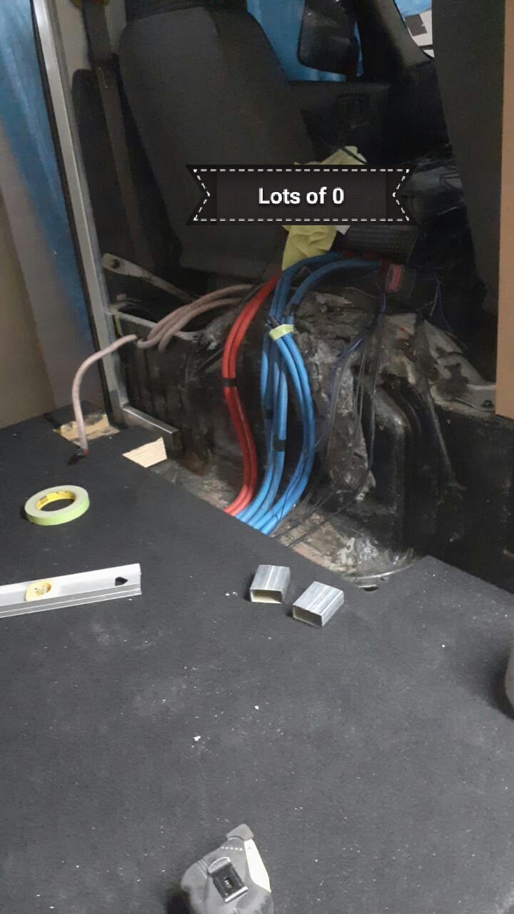

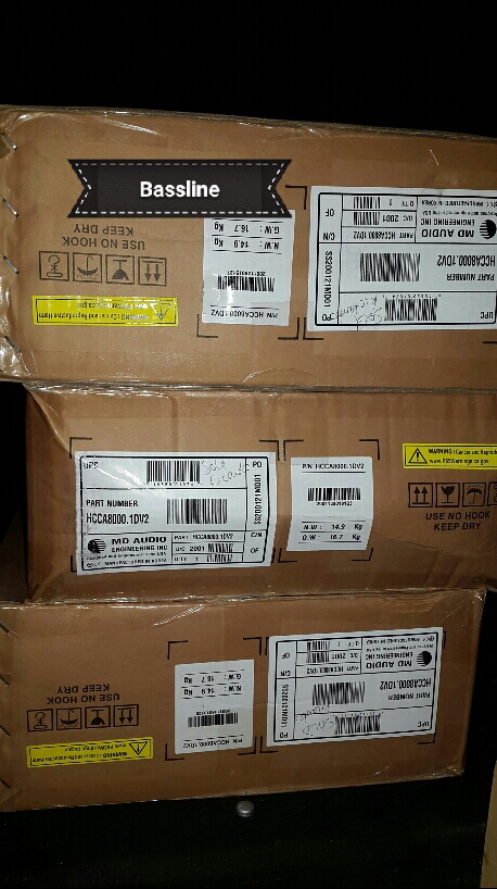

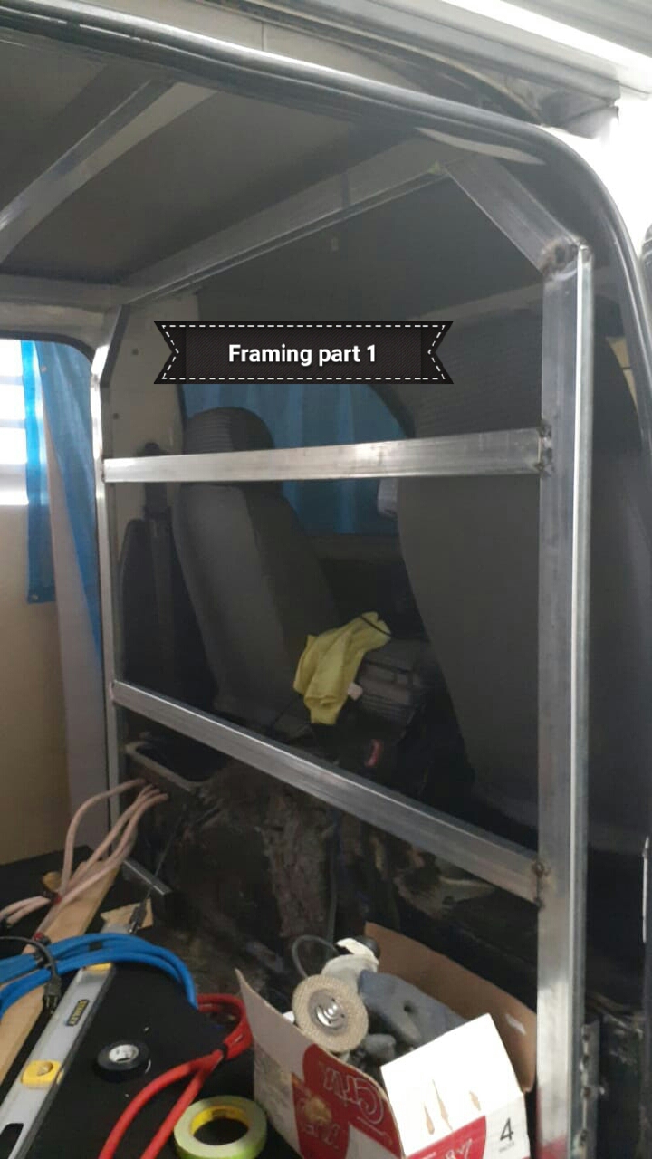

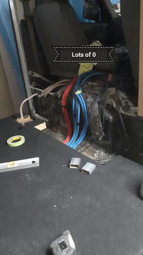

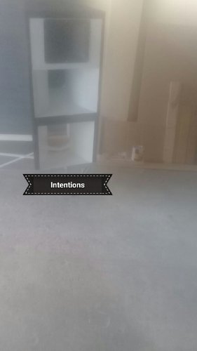

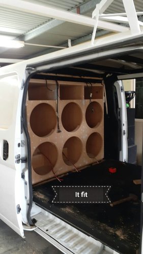

Been at this for some time, finally reached a spot where I could create a thread as the build is almost done. Pics are not necessarily in order but you'd get the idea.
Details of build
Mids Section

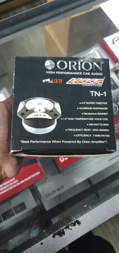

8 HCCA TN-1 supper tweeters(powered by hcca 1000.4)
4 b&c de75(me 60 flares) powered by hcca 1000.4
4 b&c 10mbx64(powered by hcca 3000.4)
4 b&c 12fw76(powered by hcca 3000.4)
Bassline

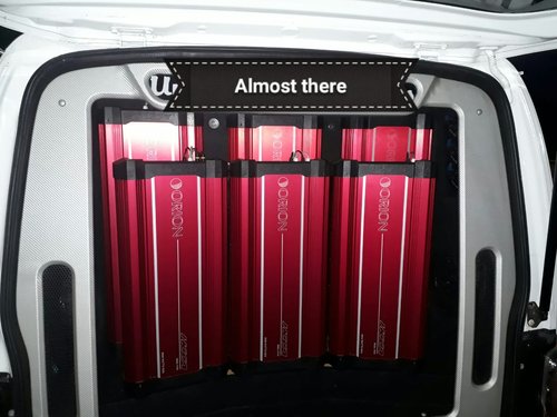

6 15 hcca orion. Each pair is powered by an orion hcca 8000.1 version 2 mono.
Current supply

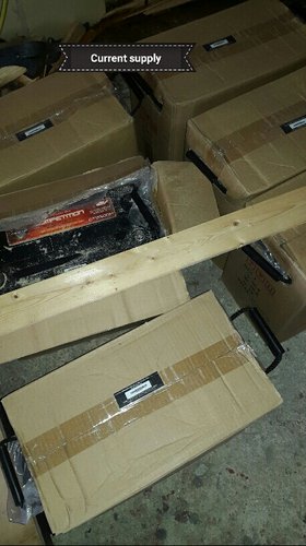

3 320A mechman alts
12 ct3500 vmax batteries
1 alt per bank of 4

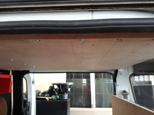

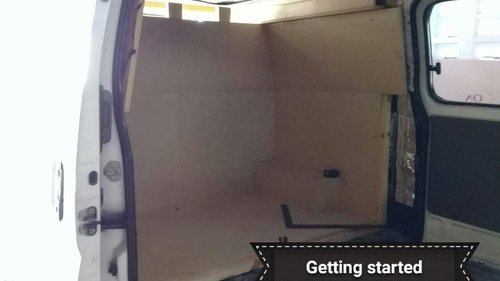

A lot more work was done in "boxing" of the interior of the van. Will post more pics soon.

Re: E25: 6 15S build
Postby Rovin » April 29th, 2021, 6:21 pm

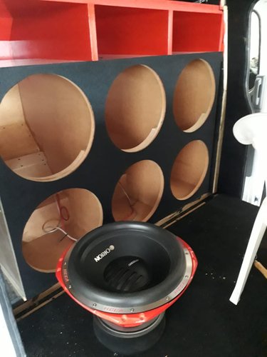

can u explain whats going on in d pics & curve inside d box
i have an idea but better to hear it from u as d owner ...
Postby shake d livin wake d dead » April 29th, 2021, 7:15 pm
Boy I was doing the write then one setta covid info started coming in...

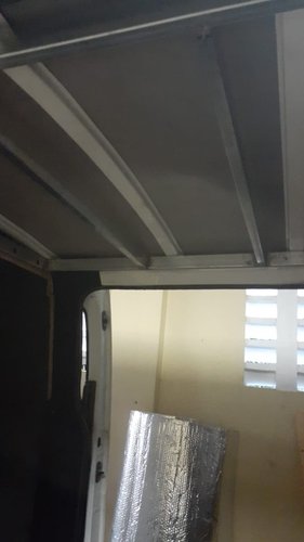

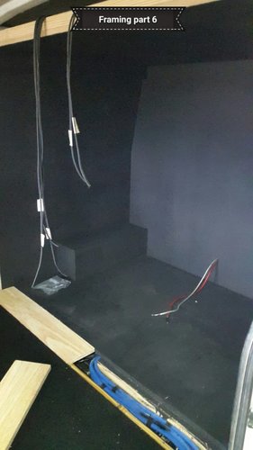

First two pics is a continuation of the "sealing" and "boxing" of the vehicle. Still has some stuff to do to neaten and get the finished product.

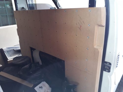

As per the sub enclosure, 3 separate boxes! Going to start tuning at 38hz with the end game at 36 after subs break out. Enough space is left to adjust port accordingly.
