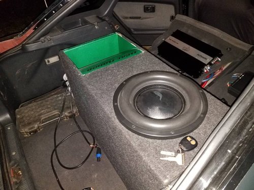

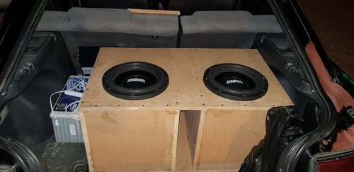

It started with a 12" atomic apocalypse in a 2.5cube box tuned 45hz on a rockford prime 1200.1, then i whet to a single 12" dd 712 2.5 cube box tuned to 42hz on a powerbass asa 1500.1, then to a double sundown sa 10 in a 2.5 cube box tuned to 40hz on a deaf bounce 2000.1. Each time boxes were built over, electrical is a 140amp alt, xs d 1200 infront and xp 3000 in rear, nvx 0 gauge ofc wire for runs and big three. I put my subs in a feilder and it was night and day difference on less power, i took the single 12 sub from the fielder and put it in the hatch on more power and it sounded softer. I also tried sub and port facing forward, up, rear, even presently the both sa10 face up with port back with same issue.

well if you switched enclosures and the new box still sound anemic in yours, and your box sounds good in the other vehicle, it's not the box. it not sounding like an electrical power feeding problem either. 0 awg cable will allow for nuff current.
checked the stereo bass settings? did you check that the gains on the amp and preamp adjusted correctly?
i hate these kinda issues, but sometimes the simple things are the cause of these headaches. i say start from the power source & the deck and work your way back.

Deck is a 80prs...all gains were set using the dd1. Thats why it strange to me, the only think i could possibly think of is something with the trunk itself. It rattles alot and bass just doesnt seem to travel out of the car. Inside sounds great but from outside it sounds as if everything is compacted inside. There is not pre amp, just cross over set on deck, and gains on amp...The wheel well has some holes and apparently the spaces where the back shocks are is leaking air... alot air comes through there when the sub is playing, not sure if that could be the problem

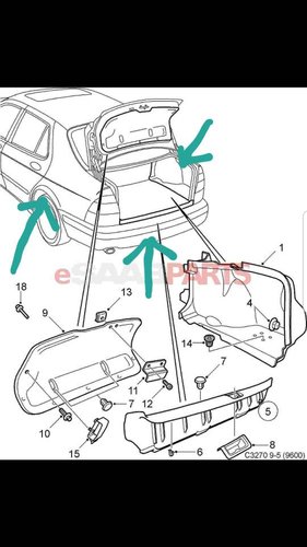

Its not leaks in the box...its leaks in the hatchback itself....its a bit rusty, has some holes and spaces in the trunk(wheel well ect..where the arrows point is where alot of air comes out when the sub..standing next to the car from outside you can feel air being forced through there

you may need to stop those leaks (some metal sheeting work required ) and dynamat the trunk

Lol. But those leaks are the problem?

not likely

Subs up, port up and make a baffle that seals off your subs from the trunk (so the look like they're sitting on a rear deck). You're welcome.
