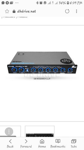

Ok guys, my bad it was 500hz - 3000hz. I double checked it. And yes its no external crossover. I bandpass the mids using the on board crossover. Amp is a SS TN4.900D.
I really wanna start the speaker at say 250hz but at high volume that 50hz messing me up. Only processing i have between hu and amp is a massive eq7. Will be changing that to a db drive speqp as i got it online real cheap.
