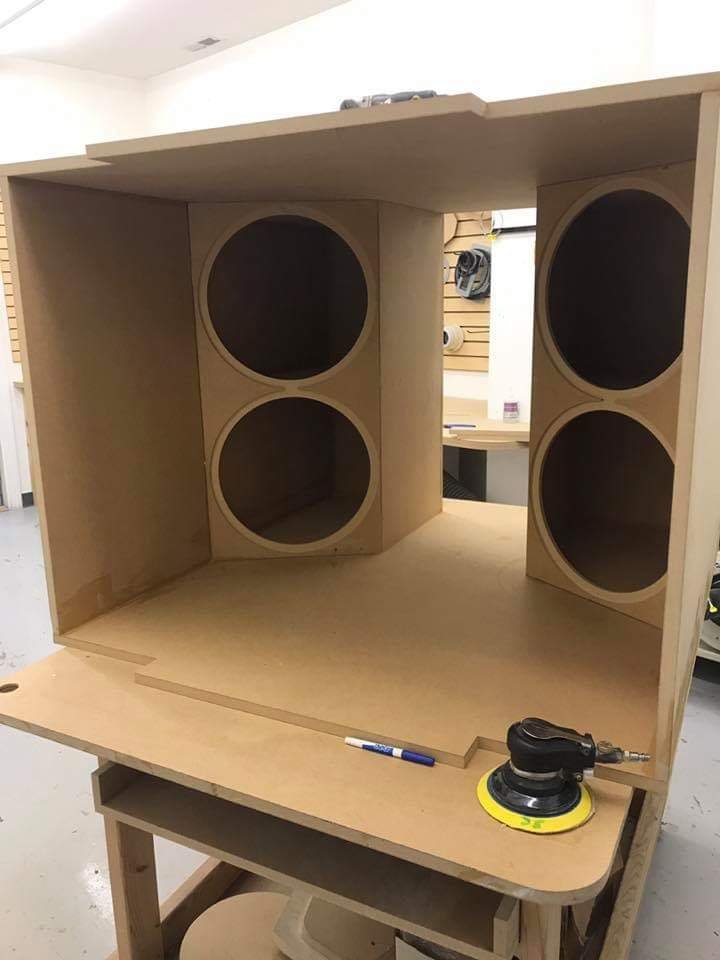

SR wrote:Not mines but hoping to see builds like this...FB_IMG_1540322542237.jpeg
I'm curious about the choice of MDF instead of good ply for a build like that. MDF is heavier and the slightest bit of dampness can screw up the box. Allyu didn't just suffer from flooding? :)
hmmm..nice concept
Too soon, Brian

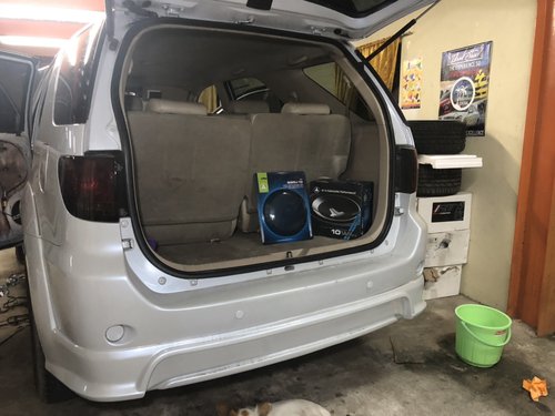

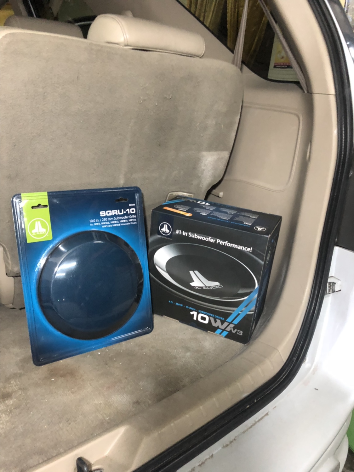

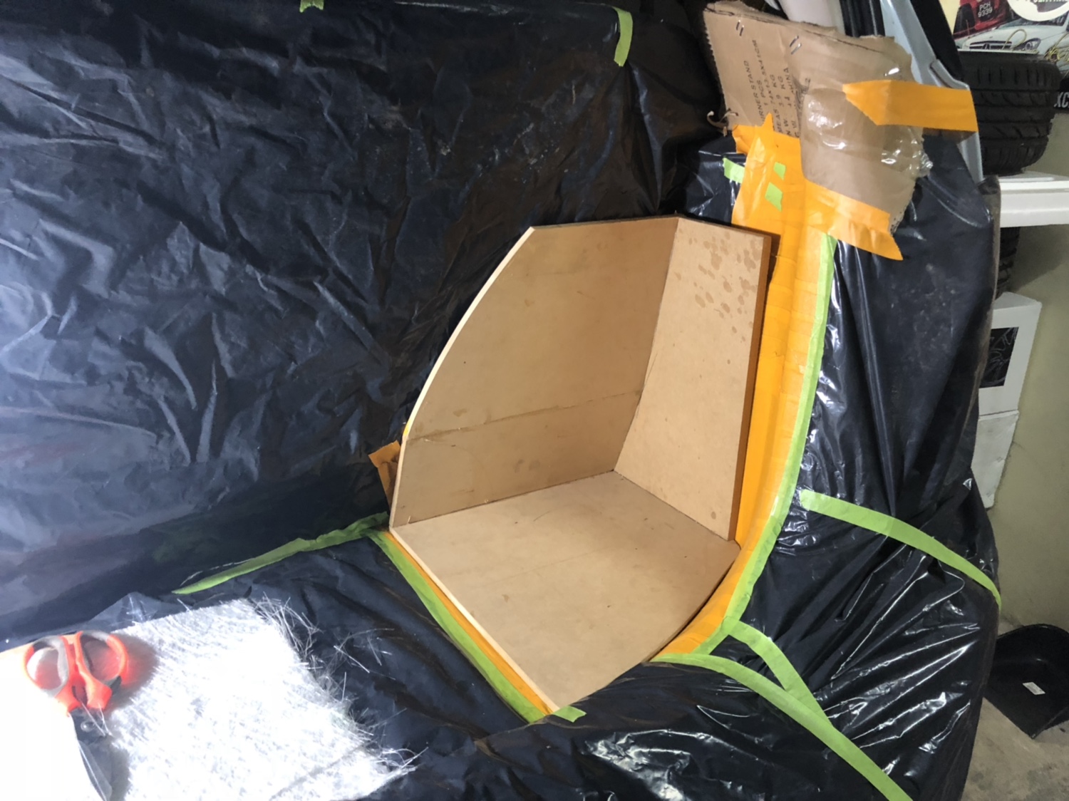

Ok so I working on a Toyota fortuner
7 seats
Little space
1 - 10” JL audio and grille
jusrocky
Posts: 170
Joined: March 31st, 2008, 11:08 pm
Re: Sub enclosure build
Postby jusrocky » October 27th, 2018, 1:45 am
Any ideas?

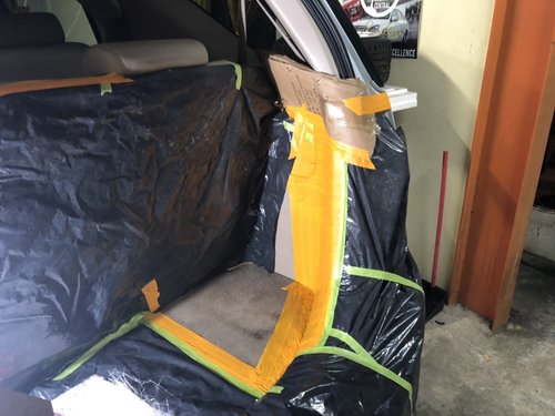

Have space under that floor or?
jusrocky
Posts: 170
Postby jusrocky » October 27th, 2018, 7:03 pm
kavaninho wrote:Have space under that floor or?
Nope
Jus bout 1/2 inch

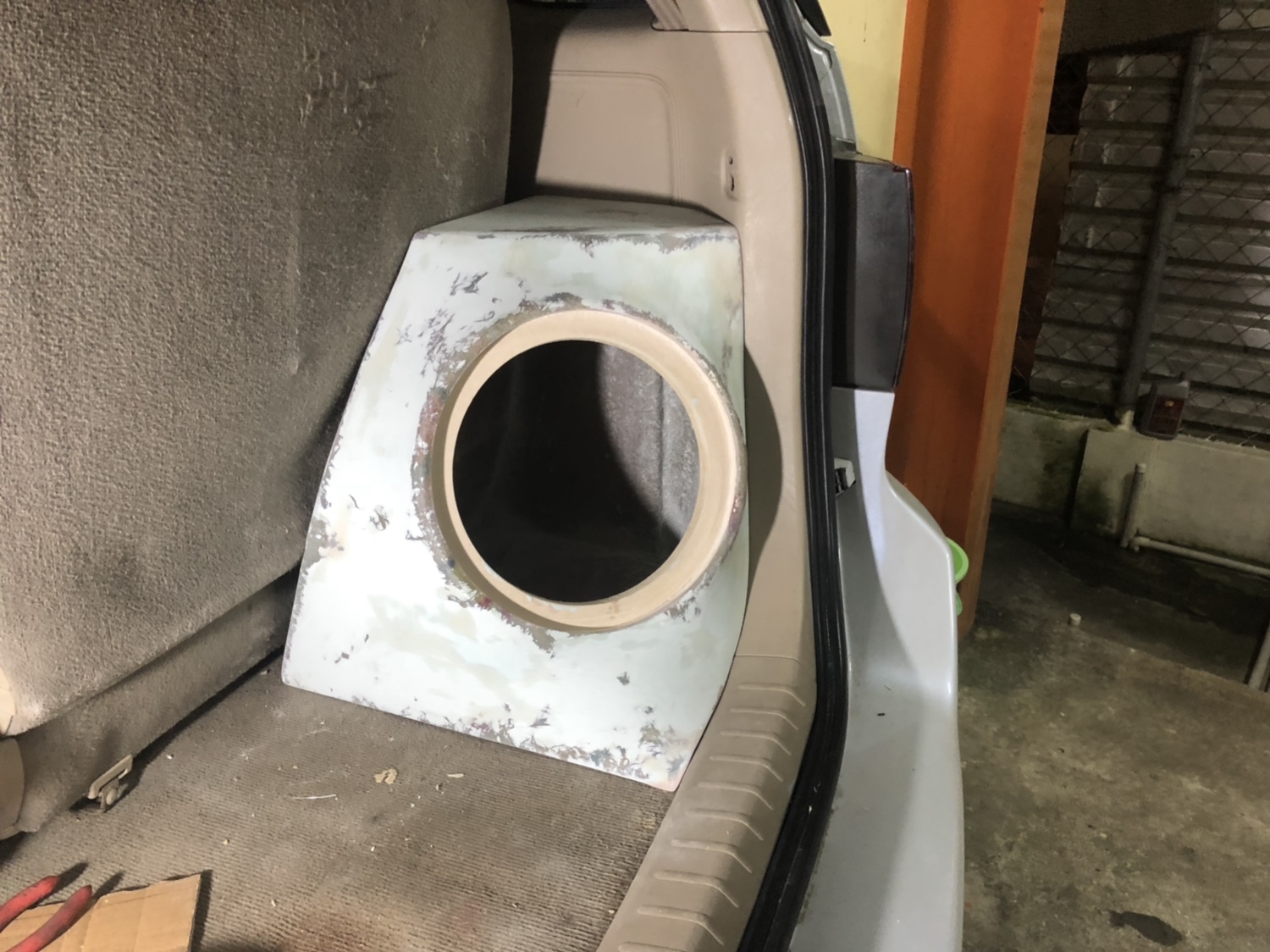

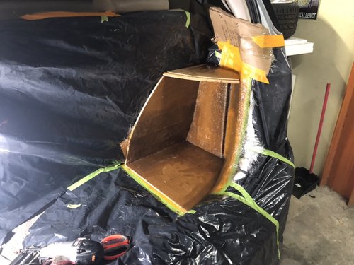

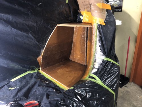

Postby jusrocky » October 31st, 2018, 12:27 am
So fiberglass it is!
Let’s see how it goes

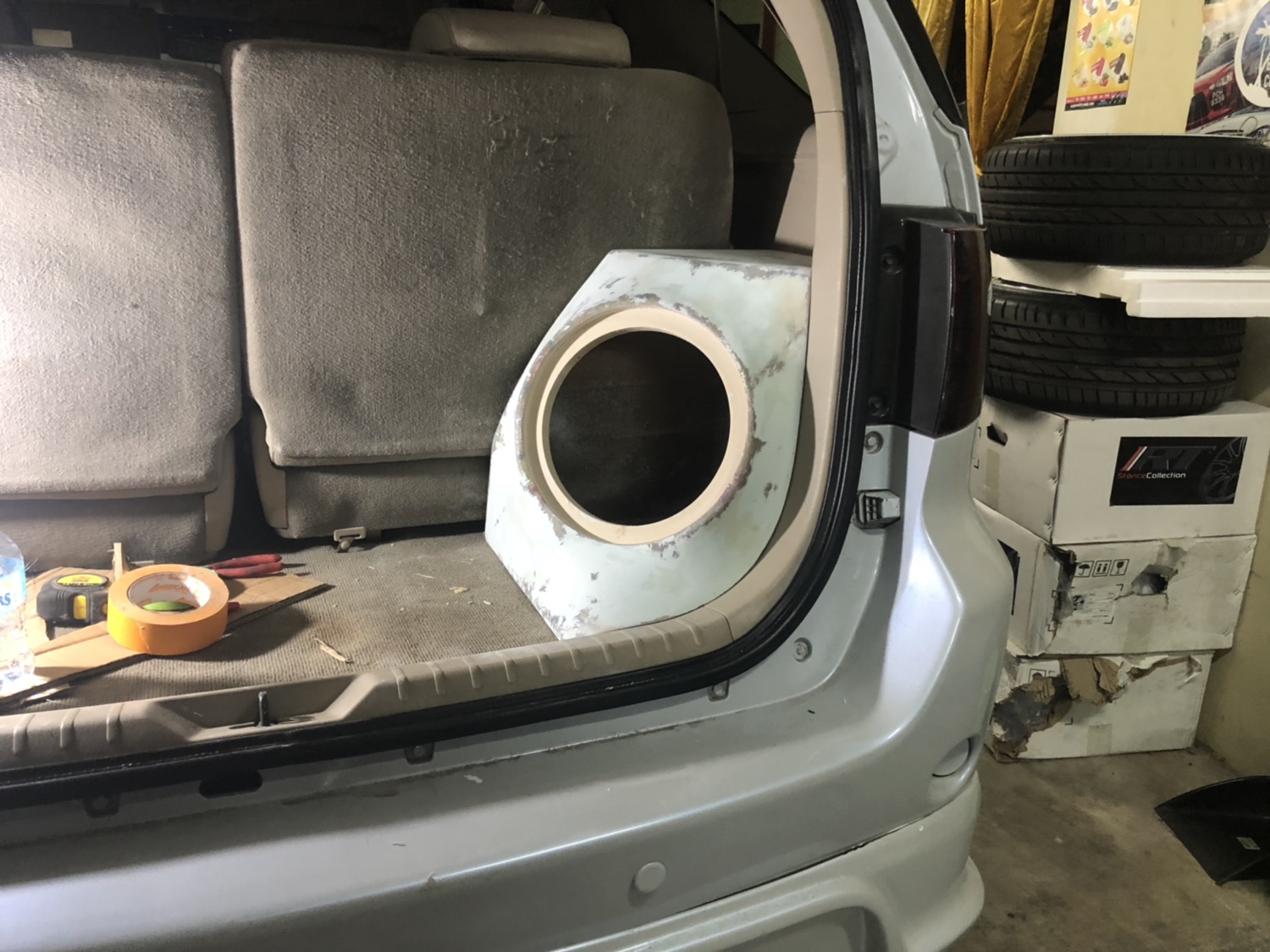

Postby jusrocky » November 2nd, 2018, 12:36 am
Moving along
Postby ruffneck_12 » November 3rd, 2018, 8:47 pm
okay now we can help you since you gave us more information. (do this from the start next time nah , Jesus Christ boy)
Anyhow it looks great man

Postby jusrocky » November 7th, 2018, 11:43 pm

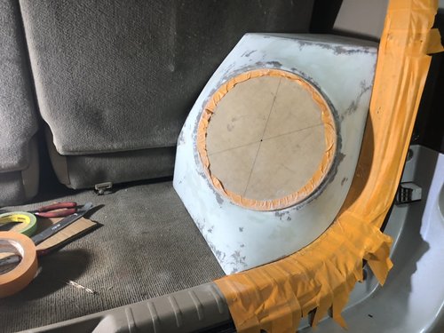

Paint, carpet or leather?
Brian Steele
Posts: 877
Joined: December 3rd, 2009, 5:37 pm
Postby Brian Steele » November 8th, 2018, 12:13 am
Duratex.
Carpet looks ratty after awhile, and leather will get scuffed and damaged if you use the trunk to hold anything else.

Postby pjfred » November 8th, 2018, 5:31 am
How did you suspend that mounting surface for the sub?

Postby X_Factor » November 8th, 2018, 2:21 pm
curious as to why the 10w1 and not the 10w0 since mounting depth was not an issue
they both have the same rated power and xmax but the w1 is a couple 100's$ more
what kinda internal volume you got?....
jusrocky
Posts: 170
Postby jusrocky » November 9th, 2018, 2:05 am
Brian Steele wrote:Duratex.
Duratex wont match nothing in the interior

pjfred wrote:How did you suspend that mounting surface for the sub?
I made some wedges
Sorry I don’t have any pics of that because I forgot to take some

Postby jusrocky » November 9th, 2018, 2:20 am
X_Factor wrote:curious as to why the 10w1 and not the 10w0 since mounting depth was not an issue
So the 10w0 only comes in single 4️ and I wanted a 2️ so that’s why I use a 10w1
The volume was around 1.1cubic enough to be ported but I didn’t have the length so I went seal instead
Didn’t really wanted to go that way but I had no choice
Postby nervewrecker » November 9th, 2018, 9:10 pm
some people does just hot glue some sticks in place like pallet sticks or anything else kinda sturdy that can be removed with ease after.
Enclosure looking good OP. Great work so far, waiting to see the finished stuff.
