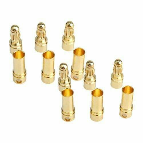

Postby X_Factor » August 4th, 2018, 11:12 pm
I didnt have access to ferrules so I improvised with this
I used the male ends

X_Factor wrote:I didnt have access to ferrules so I improvised with this
Lovely! Anything to improve on connection or conductivity and u on the right path...where u got those btw?
