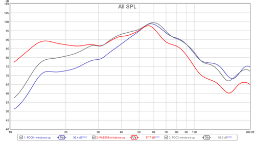

Brian Steele
Posts: 877
Joined: December 3rd, 2009, 5:37 pm
Re: Enclosure Myths
Postby Brian Steele » April 12th, 2018, 6:25 pm
Rovin's Audio wrote: i have owned\used IA subs & imo if u tune them high u wasting a good sub , like most american brands they were built for their market : to hammer d lows with alot of smooth overall output , not what locals do to them ex tune it 45hz for loudbass
I usually advise that, if you're going to build a vented sub, tune it to the lowest frequency you want to produce. If you don't know the answer to that, then choose 32 Hz :-). Cabin gain makes up for a lot of issues in car audio....
Having said that, for a lark I recently built an offset TL that was tuned to 48 Hz, using the same cheap PA 12" driver that I used for my POC TH design. It actually didn't sound too bad with normal music (not that re-bassed stuff which stretches the term "music" just a little), and properly filtered (i.e. to make sure nothing below Fb got through to it), it actually didn't sound to bad.
I've attached an FR test I recently did with my car audio subs (2 12" Alpine Type Rs in a sealed cabinet, wired for a 2 ohm load), my POC3 TH loaded with an Eminence Kappalite 12" 4 ohm driver, and POC6, the 48 Hz offset TL described above. Both the POC3 and POC6 TL were MORE sensitive than the Alpine Type Rs above 50 Hz, sometimes up to 6dB more up to 100 Hz. Below 50 Hz the POC6 TL dropped off a bit faster (obviously because of the 48 Hz tuning), but the POC3 TH kept up with the Alpines all the way down to 30 Hz.
For raw SPL the Alpines will likely win (duh - two 12" drivers with 20mm Xmax, vs. one 12" driver with 9mm Xmax (the Eminence) and one 12" driver with 5mm Xmax (used in POC6), but we're talking about drivers that at least are double the total cost that are pulling up to 4 times the power at the same input voltage. Damn.
BTW, the FR curves also show that going with a 30 Hz vented sub for my car might be a better fit for it, but that's a whole other discussion. Plus I don't mind trimming the output at 50 Hz a bit with EQ so I can enjoy flat response down to single-digit frequencies :-)
